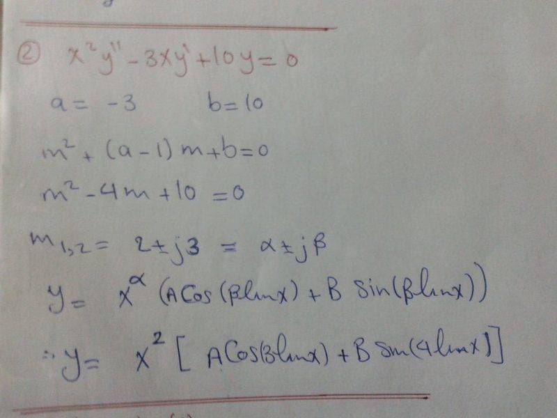

i don't understand why did we change the formula so that only one variable is in it
would it matter if p(x) and r(x) are not constants ? (i.e : something like p(x)= -3/x2 ) after all whether p(x) is a constant or -3/x2 it is after all a function of (x) , then i am on the right formula as the general formula of 2nd order ODE's y" + p(x) y'+ r(x) y= g(x) , right ?
these are 2 solutions (attached ) , mine (the wrong one) , and the other is the model answer (but i see it has an error , m should be 2±j√6 )
... to make the maths easier.
The DE to be solved is: ##x^2y'' - 3xy' + 10y = 0## ... here y is a function of only one variable.
Neither of your worked examples has a p(x) or an r(x) in them, and you don't explain your reasoning as you go.
So it is difficult to see what you are asking. It sounds like you are applying a method to get a solution that you don't understand.
I suspect you are thinking of "reduction of order" ...

indeed , :) thank you a lot ,
one more thing please , this is a quote from Paul's Notes on reduction of order
"Reduction of order requires that a solution already be known. Without this known solution we won’t be able to do reduction of order. "
but the in this problem i wasn't given any solution of y(x) ,
is there any other way to do "reduction of order" that doesn't require already knowing one of the solutions ?
If you have a differential equation such as ay''+ by'+ cy= 0 with constants a, b, and c, then its "characteristic equation" is ar^2+ br+ c= 0. We can get that by arguing that, in order for y, y', and y'' to cancel when multiplied by constants, y, y', and y'' must be the same kind of function. And exponentials have that property. If we try [itex]y= e^{rx}[/itex] then our differential equation becomes [itex]y= e^{rx}(ar^2+ br+ c)= 0[/itex]. Since [itex]e^{rx}[/itex] is never 0, we must have [itex]ar^2+ br+ c= 0[/itex], the "characteristic equation above.
But that applies only to "linear equations with constant coefficients". If we have linear equations with non-constant coefficient, as, for example, [itex]x^2y''- 3xy'+ 10y= 0[/itex]. That does NOT have constant coefficients so you cannot use the same characteristic equation as above. What you can do is observe that the change of variable [itex]t= ln(x)[/itex] changes the equation from an "equipotential" equation (the power of x multiplying each derivative equals the order of the derivative) in x to a "constant coefficients" equation in t. That is, if [itex]t= ln(x)[/itex], then [itex]dy/dx= (dy/dt)(dt/dx)= (dy/dt)(1/x)[/itex] and [itex]d^2y/dx^2= d(dy/dx)/dx= d((dy/dt)(1/x))/dx= (1/x)(d(dy/dt)/dx)- (1/x^2)(dy/dt)= (1/x^2)(d^2y/dt^2)- (1/x^2)(dy/dt)[/itex] so that [itex]x^2(d^2y/dx2)- 3x(dy/dt)+ 10y= (d^2y/dt^2- dy/dt)- 3(dy/dt)+ 10y= d^2y/dt^2- 4(dy/dt)+ 10y= 0[/itex]. The characteristic equation of that "constant coefficients" equation is [itex]r^2-- 4r+ 4= (r- 2)^2= 0[/itex] which has 2 as its only root. That means that the general solution to the constant coefficients solution is [itex]y(t)= Ae^{2t}+ Bte^{2t}[/itex]. But [itex]t= ln(x)[/itex] so that [itex]y(x)= Ae^{2ln(x)}+ Bln(x)e^{2ln(x)}= Ae^{ln(x^2)}+ Bln(x)e^{ln(x^2)}= Ax^2+ Bln(x)x^2[/itex] is the general solution to the original equation.
However, linear equations with other non-constant coefficients often cannot be written in terms of "elementary" functions. For example "Bessel's equation", [itex]x^2y''+ xy'+ (x^2- n^2)y= 0[/itex], which is almost an "equipotential" equation, has as its general solution [itex]y(x)= AJ_n(x)+BY_n(x)[/itex] where "[itex]J_n(x)[/itex]" and "[itex]Y_n(x)[/itex]" are the "Bessel functions of order n of the first and second kind". "Bessel functions" themselves are defined as "the independent solutions to Bessel's equation".

ohh ! i have just noticed when i was trying the solution
the characteristic equation should be r^2 -4r + 10 =0 +10 not +4 , right ?
