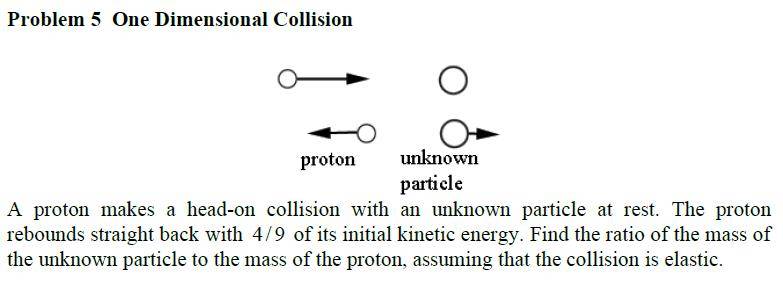

You might like to try the following from an MIT problem set (Physics 8.01 Fall 2012).

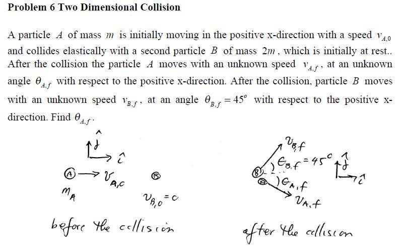

You might like to try Problem 6 from the same MIT Collisions Problem set as Problem 5 above. (PS: if anyone from MIT views this, please advise on how I should reference this particular problem set which I downloaded some time ago but can no longer find online. It's Problem Set 7 dated Fall 2012).
As before I'll eventually get round to adding this as another worked example using the alternate method.
SergioPL said:
The use of the reduced mass is restricted to the scenario of frontal approach, that is the reason why this formula is not widely used to explain the phenomenon, since the use of general expressions is in general preferable.
See Insights article on 2 dimensional collisions. Eventually decided the topic warranted another article altogether rather than just an additional example here.
