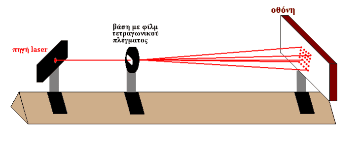

The experiment looked like the second pic, but I couldn'tfind it in English. Translation from left to right is:
"Laser Source", "Glass Piece with Ridges", "Screen"

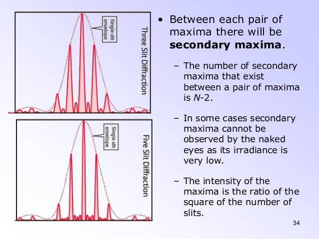

From the drawing that you posted, it seems that you observed an array of diffraction maxima produced by a two dimensional array of apertures. This happens because of interference. Is that what you are asking about?
Also, the wavelengths that you found are not in the visible range (7000 - 4000 A). You must have made a mistake either in the interpretation of the data or in your calculation of the wavelengths.

Why do you have different colors if you're using a laser?
Ah, is that what it's called? I just did a direct translation and went with "Barrier". I get why that happens, the leaflet's question is:
