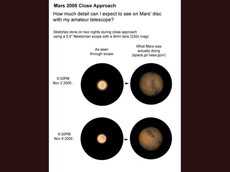

Here's a couple of sketches I did of Mars. On the left is what I saw; on the right is a software-simulated view of what Mars looked like at those exact dates and times. I'm pretty pleased!

Really liked the Mars pictures. That's quite a view.
