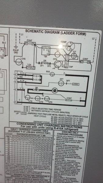

@jim hardy . He is our resident go to guy on motors and such. A diagram or a link to a diagram would be most helpful. It's possible the capacitor could have failed in the short circuit mode at some point. The last outdoor unit I worked on with a bad capacitor tripped an overload relay within seconds, but this was on the compressor, not the fan.
This is a photograph of the schematic diagram for this unit.
From the schematic the Fan motor is a Capacitor Run type, that is, it's a 2 phase motor. Most likely the capacitor failed as Open, as most electrolytic do. (ball-park lifetime roughly 10yrs.) This happens when the liquid electrolyte in them dries up with age and temperature. Without the capacitor there is no rotating magnetic field in the motor and the motor does not turn. This gives the same effect as if the motor shaft was locked so it could not rotate.

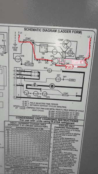

Current from L1 goes through contactor and DR relay, arrives at fan motor COMMON and splits between the two windings.
RUN winding current exits straight to L2
START winding current has to go through start cap to get to L2
and if cap won't let it out the motor can't start
When that happens the run winding will draw very nearly LRA because the motor can't get up to speed.
So one of two things happens -
EITHER
the motor's internal thermal overload cutout (if there is one) will cycle open-closed-open...etc because the run winding heats up until thermal cutout opens and motor cools back down , and cycle repeats ...
OR
the run winding overheats and burns up.
You can sniff the motor to smell for burnt windings, and maybe look in the vent holes on end to see if they're bright copper or charred ,,
With your readings i'd guess that the run winding is charcoal.
Anyhow - that's how a failed start cap can wreck a motor.

that'd be this one and it's for the compressor
i've seen them called "Hard Start Kit". My local plumbing/electrical parts store carries them.
Capacitor SC is probably a few hundred microfarads to get the compressor started
after startup relay SR disconnects capacitor SC and the compressor continues running as a PSC on the 40 uf side of the dual run capacitor
fan both starts and runs on the 5 uf side of it.

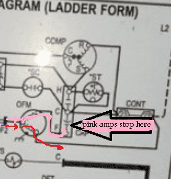

fourthindiana said:
then a PSC motor should start if the current went through both windings but the start winding current got stopped at the run capacitor because the current through the start windings went all the way through the start winding.
remember your Kirchoff
in a series circuit current is the same everywhere
what goes in must come back out , and if it can't get out it won't go in. .
pink current is zero edit - or almost zero...
When motor tries to start red current will be LRA and that's why your run winding is burnt up.

fourthindiana said:
I'm a little bit confused. When you explained how having a defective run capacitor prevents a PSC motor from starting, you said that the current goes through the start winding, but the current that went through the start winding gets stoppped at the defective run capacitor.
i see now the source of confusion

i see where my wording confused you.
Start winding and that 5 uf capacitor make a Series circuit so current is the same in both of them.
My thinking was as follows:
Since you found the capacitir not completely open , current was more than zero but not by enough to let the motor start -
You said the capacitor read something like 0.7 microfarads not zero microfarads
so your 'almost open' capacitor choked off current through that winding so much that the motor couldn't start , and it died trying.""""If the only current requirement for a PSC motor to start is to have there be current through both windings, ...""
Well, each winding needs to have enough current to create its share of the magnetic fields inside the motor..
This is how one's thought process evolves, in little steps.
First we grasp the mechanics of the principle, that's the qualitative part.
Then we refine our thinking by adding numbers to it - the quantitative part.
Keep up the good work.
If the capacitor was completely dead with 0 microfarads, then the pink current would be exactly zero; correct?
If the capacitor was only .7 microfarads, then the pink current would be almost zero; correct?
