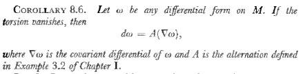

Right. But be very careful. In mathematical literature you will find two different conventions for the exterior derivative. For instance in your first equation you have factor 2. In some textbooks you will find it lacking!
For instance here is an extract from Kobayashi-Nomizu, Foundations of Differential Geometry, Vol. I p. 149

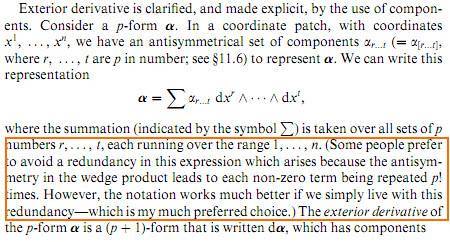

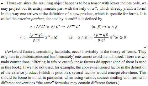

I see your problems. Look at that (taken from Penrose):
Now, when Penrose writes "Some people", it may well mean "most people". So, please, tell me whether you want to learn using the convention of Roger Penrose, or the convention of "some people". Or, perhaps, you want to learn both. Mixing two different conventions will necessarily lead to confusion. If not today, then tomorrow or after-tomorrow.
I'd like to learn both. If it helps to pick one convention to concentrate on begin with, I'd pick what most people use. When I see an expression in which Penrose has used an "is proportional to" sign, I'd like to know where most people would put the 1/p! to make it an equality.

Assuming this generalises to any possible value of p, Avramidi's definition differs from Penrose's,
[tex](\mathrm{d}\alpha)_{\mu_1...\mu_{p+1}}=\partial_{[\mu_1} \alpha_{\mu_2...\mu_{p+1}]}[/tex]
by a factor of p+1, and from the definition in #13 by a factor of (p+1)/((p+1)!). Is that right?

Is Penrose's definition equivalent to that of Kobayashi/Nomizu, assuming no torsion in either case? Would it possible, in principle, to deduce this, given the information I have, or would I need to know more about what conventions Kobayashi/Nomizu have adopted.
Do the Cristoffel symbols vanish in these definitions for some reason related to them being symmetric in their lower indices?
Yes, it seems his conventions are the same as in Kobayashi. His "components" are different from those of "some people". Here is an extract from p. 97 of Fecko, "Differential Geometry and Lie Groups for Physicists" (very good book):
Argh, so antisymmetrisation, the wedge product, the exterior derivative, and even the components of forms (and possibly other tensors) each suffer from differing conventions in how they're defined?! Thanks for the warning! I think the best thing for me to do is to try and get the hang of one consistent set of definitions, then branch out from there. Guessing (or trying to "derive") what one author means from my partial, and likely flawed, understanding of another author's system is probably not the most efficient way to learn the basic concepts. But it certainly helps to be aware that there are differences, and where they lie. As with any complex suject, comparing different explanations can often clarify a point.
