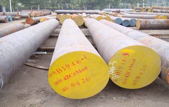

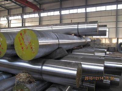

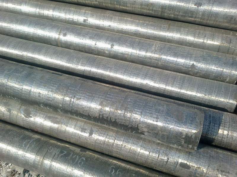

hello,
we can machine the 42CrMo4 forged round bars.
We are a leading forged carbon, alloy and tool steel bars manufacturer from China. Now I take the opportunity to introduce our company to you.
(1) Our company profile.
We are Shijiazhuang city Qilu Special Steel Sales Co., Ltd, the sub-company of Qilu Special Steel Co., Ltd, which is a steel manufacturer founded in 1986 and located in North of Jiuguan Fly-over Bridge, Yanzhou city, Shandong province. By now, it has been one of the largest forged bars producing base in China.
We specialize in producing forged metals in different shapes and specifications. Our product quality has passed ISO9001:2008, shipping register of China, South Korea, Japan, Italy, France and so on. Being famous for its preferable quality and competitive price, our products enjoy great reputation both at home and abroad. More than 50% of our products are exported to overseas.
(2) The type of steel we can supply--- forged round bars, forged square bars, forged flat bars.
300 kinds of steel forging products in 13 series, such as alloy structural steel, alloy tool steel, carbon structural steel, carbon tool steel, bearing steel, stainless steel. Shapes---forged round bars, forged flat bars, forged square bars, forged blocks, etc.(AISI 4140, AISI 1045, AISI 4340, AISI 52100, AISI 8620, AISI 8620H, AISI4130, 34CrNiMo6, S355J2G3, 39CrNiMo3, H13, P20, 17CrNiMo6...etc.)
(3) The sizes in which we can supply above forgings.
Forged Round Bars--- Φ 80-1000mm;
Forged Square Bars--- 80-1200mm;
Forged Flat Bars-------thickness not less than 120mm.
(4) Surface---forged raw surface, peeled surface and rough machined surface
If you want to know more information about our company and products please contact me.
