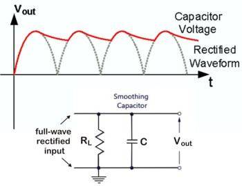

This circuit is trickier than it might appear, analysis-wise. First, let's look at the extreme cases.
1) Very small capacitor: The circuit will behave as if there is no capacitor, which would be just the positive half of the input sine wave.
2) Very large capacitor: The output voltage will be constant with a value equal to the positive peak of the sign wave input.
In more realistic cases, you will end up with a waveform like this:
This is for the full-wave rectifier, but the idea is the same for your half wave rectifier but with zero input for half of the cycles shown. Notice that current only flows during short periods in the low ripple cases, this creates more stress on the circuit components than many people realize.
Unfortunately this is hard to solve analytically. For large capacitors (= light loads, = low ripple), you can approximate this with a piece-wise linear output voltage. It is easy to calculate what is happening when the diodes are off, that is just the capacitor discharging to the load, often that is good enough. In practice, this is a great circuit to simulate to get the answers. I like LTSpice, it's free good, and easy to use. In the dark ages when simulators were not so easy to use we use to have tables and graphs to refer to.
