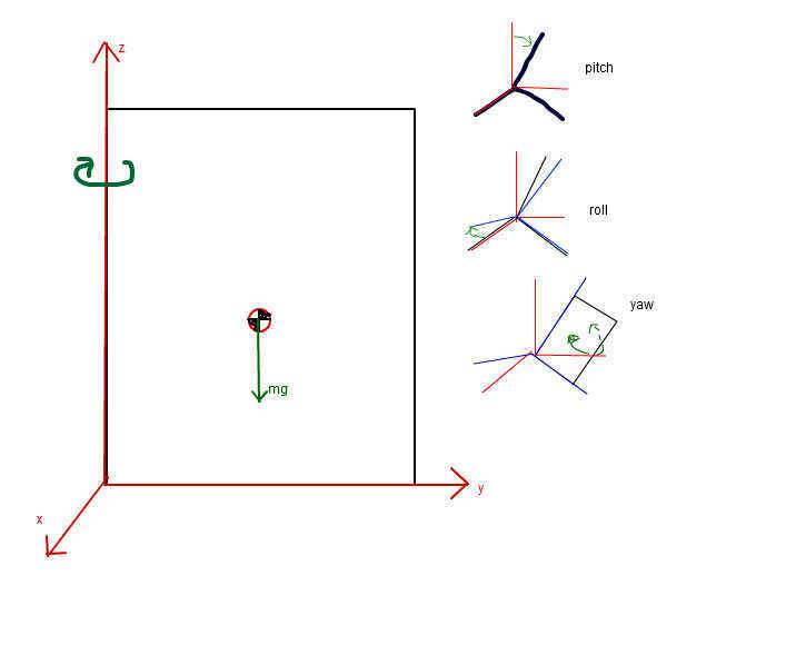

I think I'm having a really big block over a really small hangup, so forgive me. I'm on an internship and this is my first time working with rotations/change of basis in a real world scenario.
I'm creating a calculator that gives torque in a door mechanism, after a given roll and pitch of the vehicle. It's for the torque in a door check mechanism, but the general torque at the axis of rotation (along door hinges) will suffice for this calculator. I am using rotation matrices to find the component of gravity into and out of the door, then multiplying that against the distance from the axis to the CG to find the torque created by gravity.
I'm setting up the matrices in Excel.
What I've got currently is Rx*Ry*Rz, where Rx is the roll transformation, Ry is the pitch and Rz is the yaw. That successive matrix is then multiplied against the gravity vector. The calculator gives accurate values for the gravity at the center of mass after the pitch and roll, but since I haven't accounted for the distance from the axis to the CG, the Rz matrix has no effect on the gravity.
I feel like I need to add a translation or inertia matrix in there somewhere. The door is being treated as a point mass at the center of gravity.
Rx*Ry*Rz
[1 0 0;0 cos(α) -sin(α);0 sin(α) cos(α)]*[cos(β) 0 sin(β);0 1 0;-sin(β) 0 cos(β)]*[cos(γ) -sin(γ) 0;sin(γ) cos(γ) 0; 0 0 1]
Gravity Vector
[0;0;W]
where α=roll angle, β=pitch angle, γ=yaw angle, W=weight
Thanks SO much with any direction anyone might be able to help with. I've spent hours staring by it at myself, but no one on my team has used linear algebra in decades...

Originally I had aligned the y-axis with the bottom edge of the door, the z axis with the hinge/front edge of the door. The origin being at the front bottom corner. My thought was that I would just translate the door's weight vector through the pitch, roll and yaw. I didn't take into consideration the position vector of the CG. So my yaw transformation doesn't affect the weight vector because I'm applying the transformation ABOUT the Z axis TO the z axis, rather than a vector positioned away from it. Does this seem like I've pinpointed the right problem?

From the diagrams, it looks like you've got the right idea Cora.

Hi Cora,
first you have to change the order of you matrices in the product, your rotation matrix ##R## has to be ##R=R_z R_y R_x## (first roll, then pitch, then yaw; the rightmost matrix corresponds to the first transformation, i.e. to the roll).
To compute the torque, you need 2 vectors: a vector ##\mathbf a## parallel to the axis of rotation of the door, and a vector ##\mathbf r## from the axis of rotation of the door to its center of mass. The to compute the torque about this axis you need to compute the cross product of ##T\mathbf r## and ##m\mathbf g## (##m## is the mass of the door and ##\mathbf g## is the gravity vector), and then take the orthogonal projection of ##m T\mathbf r \times \mathbf g## onto the vector ##T\mathbf a##.
And https://www.physicsforums.com/threads/door-rotation-matrix-change-of-basis-plus-translation.823423/members/andrewkirk.265790/ is right, yaw does not change the magnitude of the torque.

Thanks for talking that through. I figured I was missing at least one position vector. What is the variable T?
Sorry, it was a typo, it should be ##R##.
