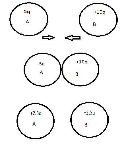

Electrical conductivity has an effect while charging by conduction?
In summary, the higher the conductivity of a material, the less resistance it has to an electric current.
kololo
Does electrical conductivity affects only the time taken for two conductors to obtain their resultant charge?
I understand that electrical conductivity is a measure of how easily charges are able to move in an object.
During charging by conduction (for conductors), it seems that we simply have to add the charges of both object together and divide by two to obtain the resultant charge of either object. Does electrical conductivity then affects only the time taken for the two conductors to obtain their resultant charge?
Likes Delta2
To charge an object you need to have an electric current into and through that object, correct? How does the resistance (or conductivity) affect an electric current?
Likes Delta2, kololo and scottdave
"resultant charge", to me, means steady state, or that nothing is changing any more, the system is stable. What can you conclude from that assumption about your problem?
Thank you for your reply, but I still have some queries.
Do you mean to say that when the particles are in contact with each other and when electrons move from A to B, there is electron current from A to B?
Since the current is voltage divided by resistance, the higher the conductivity, the less the resistance, and thus the higher the current. And since current is the rate of flow of charge, a higher current will mean that it will take a shorter time for A and B to obtain 2.5q of charge? Please correct me if I'm wrong.
Likes Delta2
Absolutely. Electrons are electric charges after all, and current is defined as the movement of electric charges.
That looks correct to me.
Likes Delta2 and kololo
Drakkith said:
Absolutely. Electrons are electric charges after all, and current is defined as the movement of electric charges.That looks correct to me.
Alright, I understand now. Thank you!
Likes Delta2
BTW I don't think its an easy problem to find a formula for the current that flows when we bring two conductors of different potential in contact , but I agree that the conductivity of the conductors will have a proportional effect to this current. Or the resistivity will have an inversely proportional effect. The reason for this is I think Ohm's law in its differential form $$\mathbf{J}=\sigma\mathbf{E}$$ where it gives us clearly that the current density ##\mathbf{J}## is proportional to the conductivity ##\sigma##.
