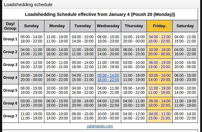

I spent a year working in Kathmandu. Power outages were not only common there, they were programmed because the grid can't cope with the demand. Load shedding they call it, and they published a timetable showing which areas of the city would have power at which times of day.
Anyway, people there use inverters as back up. They're big ugly things but they work to run small loads such as lighting, tv, router etc. I found I could run my little electric Baletti coffee maker off it, but it growled at me in protest (worth the risk for the few minutes it takes to brew coffee).
As I understand it, things have improved and load shedding is needed far less frequently now - only if in dry season there's not enough water to power the hydro-electrics.
Likes berkeman, anorlunda and hutchphd

  • #54
Attached photo is a load-shedding timetable from Kathmandu. This is from early 2016, the times slots shown are times when power is off. This was a particularly bad year, with general electricity problems exacerbated by a dispute over a new constitution which meant a blockade on the border with India, so very little getting through. Fuel, both for transport and the bottled kind used for heating and cooking, was especially badly affected.
