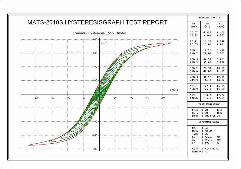

Interesting question. I'm guessing it's because ferrous metals don't support the high magnetic fields in the SMES interiors. They would saturate at much lower fields, so would probably not help to increase the inductance and energy density. But that is just a guess so far...
Wikipedia Link said:
The critical current of HTSC wire is lower than LTSC wire generally in the operating magnetic field, about 5 to 10 teslas (T).
10T is way more than an iron core can deal with, I believe. Look at the typical hysteresis curve below -- the vertical axis is all less than 1T:
http://www.magnets.com.cn/mats_pic/SA/Dynamic_Hysteresis_Loop_Cluster_of_Mn-Zn.jpg

Interesting question. I'm guessing it's because ferrous metals don't support the high magnetic fields in the SMES interiors. They would saturate at much lower fields, so would probably not help to increase the inductance and energy density. But that is just a guess so far...10T is way more than an iron core can deal with, I believe. Look at the typical hysteresis curve below -- the vertical axis is all less than 1T:
Being an ME, we had to learn EE in one year, so am a bit short on my theory. But am still having a problem. It appears you are getting something for nothing; with the same H, you are getting more B when you have a steel core vs air.
Not really something for nothing. The inductance is increased when you use a ferrous core (of appropriate material for the field strength and frequency of operation), so you can store more energy in that increased inductance. That energy comes from the power source or signal source.
