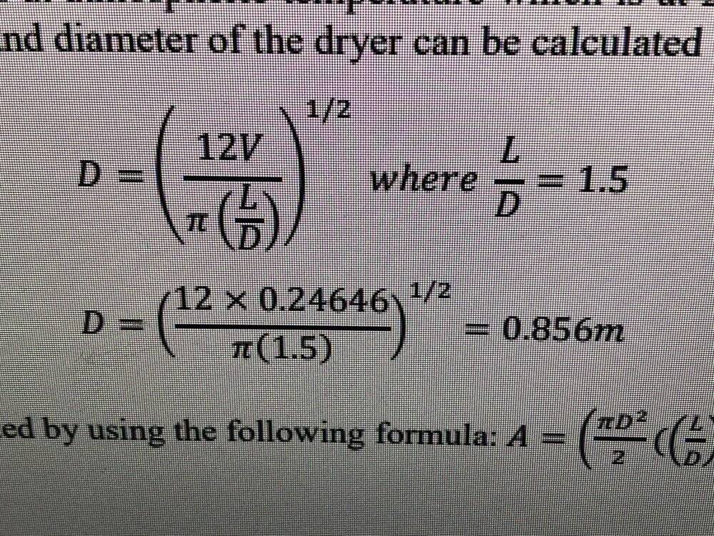

TL;DR Summary
I have come across this equation on a research paper to get the diameter of a dryer using its volume and Length/diameter ratio. I was wondering if anyone had seen it before/ knows how it is derived as I have not seen it in any books. Thanks
Will26040 said:
Summary:: I have come across this equation on a research paper to get the diameter of a dryer using its volume and Length/diameter ratio. I was wondering if anyone had seen it before/ knows how it is derived as I have not seen it in any books. Thanks
Can you provide a link to the paper? What kind of dryer?
Looks like it is just the volume of a cylinder, re-arranged, and maybe scaled so it isn't full.
The equation is dimensionally incorrect and makes no sense to me.
hutchphd said:
The equation is dimensionally incorrect...
That's common in "rule of thumb" or "rolled up constants" equations.
