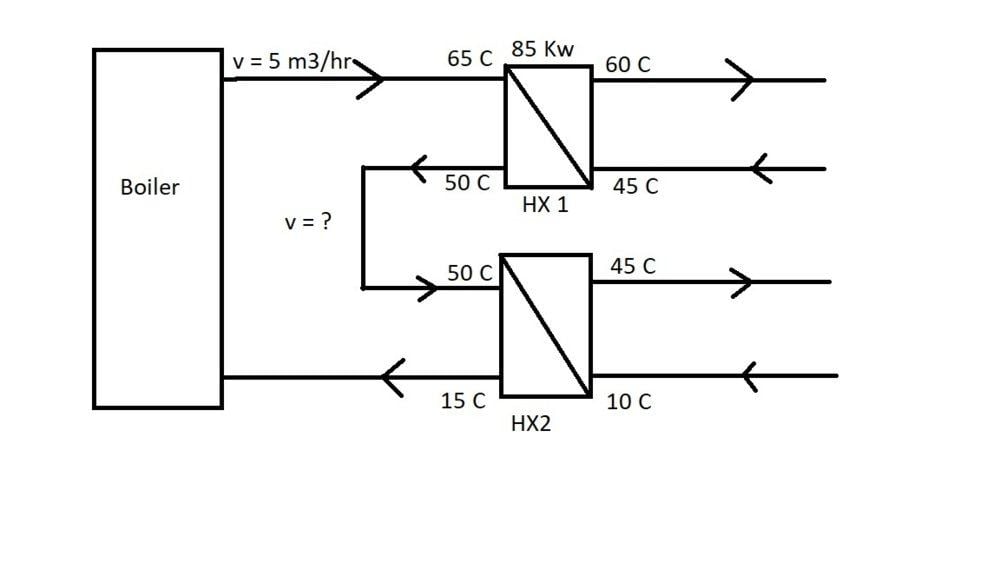

Hello All,
I am working on a project with plate heat exchangers connected in a cascade system to heat up water connections in a huge system
The Problem Statement :
A boiler produces and circulates hot water at 65 degC to a Heat Exchanger and come out at 50 degC, where as the other fluid is also water which needs to be heated to 60 degC from 45 degC , The volume flow rate of hot water is at 5.0 m3/hr and the dia meter of the pipe is DN50
Using energy Equilibrium , Heat transfer rate in the first heat exchanger
Q = m X Cp X ΔT which come around 85KW
now from the outlet of the Heat Exchange in the hot Side which is at 50 degC, I am connecting it as an Input to another heat Exchanger, which is also used to heat water from 10 degC to 45 degC and the hot water connected back to the Boiler which is at 15 degC
My question is, how can I calcuate the volume flow rate or mass flow rate or velocity of water at the outlet in the first heat exchanger which acts as an Input to second HX, so that I can calculate the heat transfer rate of the second HX to determine if need to have a pump in the circuit.
Thanks in Advance
If my question is not clear please let me know
Hello harishree, :welcome:
Your question is indeed unclear to me: if the volume flow is not 5 m3/h, where would the difference go ?
And the 5 m3/h, where does that come from, if not from a pump ?
Or:
With 'outlet' you mean the 60 C outlet ? Your heat exchange rate of 87 kW more or less dictates 5 m3/h too (with the given ##\Delta##T)

Thank you for the reply
The 5 m3/h volume flow at the inlet of the heat exchanger comes from a hot water boiler.
And by Outlet I mean the output with 50 C which acts as a input to the second heat exchanger.
My question is ...due to pressure loss in the heat exchanger (Considering 0,1 bar), will there be a change in velocity of the fluid at the exit (at 50 C) ?
No significant change. And, of course, the mass flow rate won't change at all.
Likes harishree90
Thank you for the explanation Chestermiller and BvU
I was under the wrong idea that since there will be a pressure loss in the heat exchanger, it would affect the velocity and the flow rate also.
Now I understand
