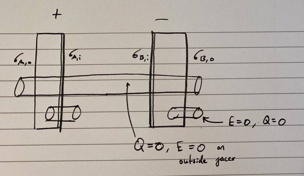

In derivations of capacitance it is standard to consider two oppositely charged, infinitely thin sheets. If we construct a Gaussian cylinder across one sheet, we obtain ##E_{1} = \frac{\sigma}{2\epsilon_{0}}## for one sheet, and then we can superpose this field with that from the other at an arbitrary point between the plates to obtain the result ##E = \frac{\sigma}{\epsilon_{0}}##.
However, a (slightly...) better model of a capacitor might be one with plates which are still infinite, but now have some thickness. One plate has a charge ##Q## and the other ##-Q##. Since the electric field is zero inside the conducting plates, the electric field strength at the surface of the plate is now just ##\frac{\sigma}{\epsilon_{0}}## (as is the case with any other conductor) since we only have to count flux through one end of the cylinder which contains a small section of the surface. Likewise, the electric field strength at any point outside the other plate due to the other plate also has to be ##\frac{\sigma}{\epsilon_{0}}##. When we superpose the two electric fields, the total electric field strength between the plates is ##\frac{2\sigma}{\epsilon_{0}}##,... but that can't be right!
I can't however see where the second approach fails. The plates are still infinite so due to the symmetry of the infinite plane the field must still always be orthogonal to the sheet, and so the field strength at an arbitrary point on that side of the sheet must be the same as that at the surface.
The only resolution I can think of is that the field strength inside the plate is non-zero, though this goes against standard theory for conductors (since then the charges would just move until an equipotential volume was again obtained). Any guidance would be appreciated, thank you!

It's not right. What do you mean by "when we superimpose"? What counts for the flux is only the charge that is enclosed by the Gaussian surface. So if one face of the Gaussian pillbox is through the conductor, the flux through the other face is (a) ##EA## if the other face is between the plates; (b) zero if it is in the other plate or beyond it on the other side.

Right, in that case we've got a layer of surface charge on the inner face of the conductor and nothing on the outer face, so I suppose that means that we do have an electric field within the conductor?

I've scribbled a few things down and it seems to me that in the infinitely far apart case the surface charge is distributed evenly on both faces, whilst when brought close together the whole surface charge is on the inner face.
I think my error is that we can't consider the plate with thickness in isolation and use the principle of superposition, since the fact its surface charge is all on one side is precisely due to the presence of the other plate.
If we take the other plate away, it just becomes another regular conductor and goes back to ##\frac{\sigma}{\epsilon_{0}}##.
Contrast this with the infinitely thin sheet, it's charge distribution doesn't change even if we bring another plate close to it so we can apply the principle of superposition without trouble.
etotheipi said:
##\dots## whilst when brought close together the whole surface charge is on the inner face.
Rethink this part. If the Gaussian pillbox encloses both plates and sticks out in vacuum, what is the electric flux through the faces?

hutchphd said:
For a finitely thick plate the charge distributes on two faces. For the same total Q the charge density σ will be cut in half relative to "thin" plate. That simple I think.
I don’t think this is correct. All of the charge should be on the inner surface.
Likes vanhees71 and hutchphd
This is what I came up with,
I did take a bit of a shortcut, for the long pillbox all that I can say is that the net flux is zero, however due to the symmetry of the situation I can pretty much say that the electric field outside must be zero. It then follows that, since the E field within the conductor is zero as well, all of the charge must be on the inner face.

Indeed. And thanks also to @etotheipi for the Gaussian pillbox drawing!
It helps to solve the most general case then look at special cases. We have three regions in space, L (left), M (middle) and R (right).
Place conductor 1 to the left of conductor 2. The field in each region is independent of position. This means that by symmetry if we swap the plates, the fields in L and R must not change, i.e. ##E_L=E_R##. Then, for a pillbox with faces in L and R,$$E_R A+E_LA=\frac{(\sigma_1+\sigma_2)A}{\epsilon_0}=2 E_RA ~\rightarrow~E_R=E_L=\frac{(\sigma_1+\sigma_2)}{2\epsilon_0}.$$For a pillbox with one face in L and one inside the conductor 1 there is only flux through one face so$$E_LA=\frac{(\sigma_1+\sigma_2)A}{2\epsilon_0}=\frac{\sigma_{1L} A}{\epsilon_0}~\rightarrow~\sigma_{1L} =\frac{(\sigma_1+\sigma_2)}{2}.$$Since ##\sigma_{1L}+\sigma_{1R}=\sigma_1##, it follows that ##\sigma_{1R} =\dfrac{(\sigma_1-\sigma_2)}{2}.##
The charge densities on conductor 2 are found simply by swapping indices 1 and 2 in the above expressions. Note that when the plates carry equal and opposite charges (##\sigma_1=-\sigma_2=\sigma##), all the charge is on the inside plates as it should be in the case of a parallel plate capacitor charged by a battery. For a pillbox with one face inside conductor 1 and one in the middle region M,$$E_MA=\frac{\sigma_{1R}}{\epsilon_0}A=\frac{\sigma-(-\sigma)}{2\epsilon_0}A~\rightarrow~E_M=\frac{\sigma}{\epsilon_0}.$$Note that there is superposition in the middle but also a factor of 2 in the denominator. In general though, if you start with two uncharged plates and you put total charge ##Q_1## on one and ##Q_2## on the other, the distributions will be as above.
