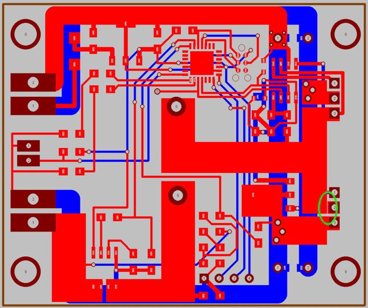

Update. With the new PCBs running the NCP3420 I was getting a better high gate wave form but things were still very off. Then after Checking to see if I had damaged some mosfets I was testing around with my ohm meter when I saw something strange.
NewPCB.png New PCB
NewPCBProblem.png The problem that was present on both PCBs
Trace is not connected on output of low side mosfet. I was unable to see in software and raw pcb because of the silk screen. This directly caused the boost circuit to not function making the high side gate driver useless.
Turns out it works like I expected all along with both revisions now when the trace is connected.
At the high risk of sounding like a jerk...
Let's review post #3:
DaveE said:
My best guess is that something isn't what you think it is. A wrong or shorted trace, a backwards diode, a 220pF cap instead of 220nF, etc. I would pause and go back and systematically verify everything, especially the stuff you think is correct. This circuit should just work.
My point is this, an essential step in troubleshooting, when you think "this doesn't make sense" is to always go back a few steps and verify your assumptions, carefully this time so you don't make the same assumptions again. The more odd something is, the more likely you are thinking about it incorrectly, then it's time to put down the scope probe and think systematically.
I've lost count long ago of how often I've seen the equivalent of your story, usually in my stuff. On several occasions I've asked other EEs to come help, just as a sanity check because they think differently than me. Often troubleshooting is quick, easy, and kind of haphazard. This is usually the best first attempt. But as soon as that doesn't work, you need to switch approaches to the most slow and logically correct process you can.
On the plus side, I'm convinced the only way to learn this is to waste a lot of time and effort troubleshooting a simple, but elusive, problem. Next time you get that feeling of "what the heck, this doesn't make sense at all" you'll remember to start over with much more care. This is "the school of hard knocks", and that's a very effective school.
