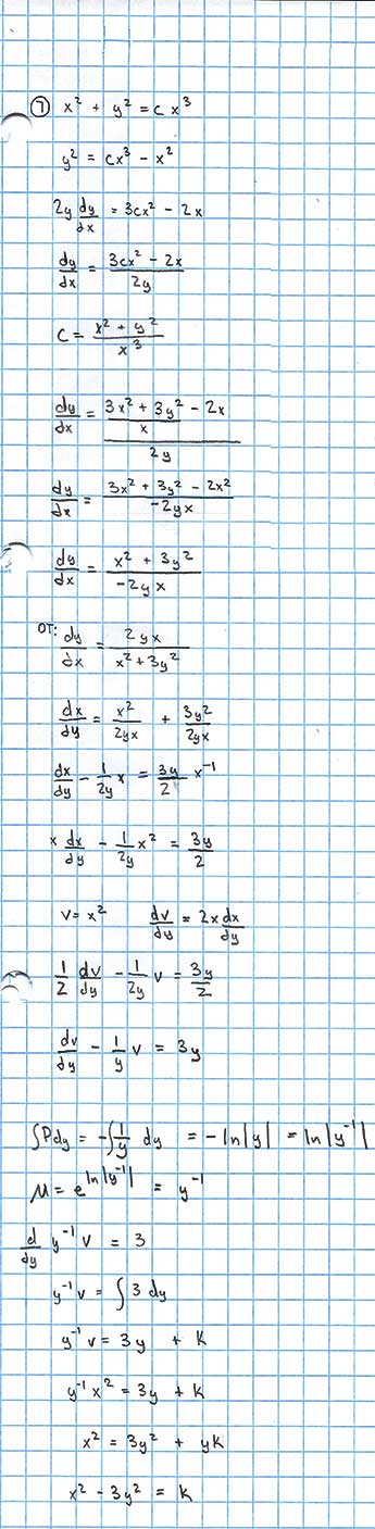

Trying to figure out the orthogonal trajectory of x^2 + y^2=cx^3
Here's what I got... but it does not match the books answer. I don't know where I am going wrong. I think I was able to differentiate the equation correctly in order to get the inverted reciprocal slope and then I may have flubbed it trying to integrate. I ended up going from dy/dx to dx/dy so that I can get it in a format I can work with and used the Bernoulli method to integrate. Where did I go wrong?

We are given the family of curves:
\(\displaystyle x^2+y^2=cx^3\)
First, we want to express this family in the form $F(x,y)=k$:
\(\displaystyle x^{-1}+x^{-3}y^2=c\tag{1}\)
If can be shown that the orthogonal trajectories of (1) will satisfy:
\(\displaystyle \d{y}{x}=\frac{F_y}{F_x}=\frac{2x^{-3}y}{-x^{-2}-3x^{-4}y^2}=-\frac{2\dfrac{x}{y}}{\left(\dfrac{x}{y}\right)^2+3}\)
Now you have a first-order homogeneous ODE to solve...can you continue?

Well I'll be ****ed... didn't even spot that... and all I had to do was multiply my OT equation by (1/y^2)/(1/y^2) to get it in that same format. I can definitely solve a first-order homogeneous ODE much more efficiently then the mess I was working with.
