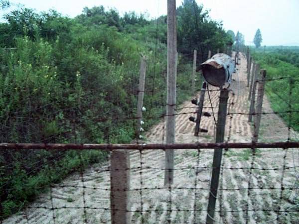

That's true of the ones on cattle ranches, but not of these:
https://en.wikipedia.org/wiki/Electric_fence#Lethal_fence
(Lethal) Electric fences are used in the DMZ, which separates North Korea from South Korea.
At the 'Lethal Fence' section, the article discusses some characteristics of military electric fence installations that have lethal energy levels. These would be designed to be difficult to circumvent, so you'd need to look into some individualities of the systems in order to create a reasonably plausible fictional scenario along those lines.

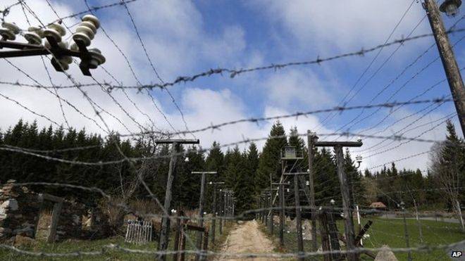

A BBC article says that deer still won't cross the Czech - East Germany border even though the fences were taken down decades ago.
This reconstructed section of that border fence looks like it would be pretty challenging:

Yeah, there's a world of difference between pulsed, 'warn off' systems for stock fences and field dividers, and the mega-zap versions shown above...
Against that, how covert do you want to go ? The 'insulated clips' thing is beloved of bank robbers and such, with 2nd-order alarm systems using a pulsed impedance bridge to spot attempted incursions. Think 'High End' detectorist gear.
But, if you really, really want to bust through a 'lethal force' electric fence, a full-on ram-raid with a front-mounted, V-shaped 'plow' grounded to an ample 'tail' of heavy chain on a tracked 'dozer' with Faraday cage fits the bill.
