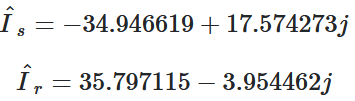

I have been struggling with calculation of the nominal value of the rotor flux. My idea was that I will use the T equivalent circuit for that purpose
and I will use nominal values of the motor quantities i.e. I set the motor operating point into the nominal operation point (nominal slip, nominal stator voltage etc.). Then I calculate phasor of the stator current (Is) and phasor of the rotor current (Ir) according to the below given set of equations
https://forum.allaboutcircuits.com/attachments/1620849888346-png.238168/
For the motor parameters mentioned above the Scilab command linsolve gave mehttps://forum.allaboutcircuits.com/attachments/1620849901203-png.238169/
Based on the known phasors of the stator and rotor current I used the below given equation for calculation of the phasor of the rotor flux
https://forum.allaboutcircuits.com/attachments/1620849925020-png.238170/
which gives λr=0.5554856−0.0613638j i.e. |λr|=0.5588647V⋅s.
This value seems to me to be too low. So I have doubts regarding the way I have used for its calculation. Unfortunately I don't know any other way for its calculation which I can use for verification. Can anybody tell me whether the applied procedure is correct or not?

I am not sure what do you mean by "rotor magnetic flux”. I don't think the leakage rotor magnetic field it has to be included since the stator and rotor main magnetic field has to be the same.
However, you may calculate-using T equivalent diagram-the current Is . At first calculate the equivalent impedance of parallel Xm with Xlr and Rr/s and then divide Vsn by total impedance Rs+jXs+jXm||(Rr/s+jXlr).The result will be the same. Ir you may calculate by dividing the Is voltage drop on the equivalent impedance of jXm and Rr/s+jXlr by Zr=Rr/s+jXlr.
I think the flux units are average values but Is and Ir are rms.
i=Imax*sin(ωt) Iav=Imax/π Irms=Imax/√2 Iav=√2*Irms/π
I am sorry. Iav=1/ π ʃ Imax*sin(ωt)dt| ωt=0 up to ωt= π| then
Iav=2*Imax/π ; Irms=Imax/√2; Iav=2*√2*Irms/π
My mistake!
