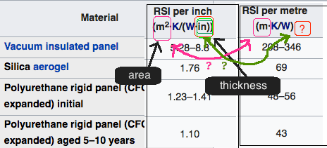

I swear, that every year, I run across an "insulation" problem, and have to re-work out why nothing makes sense, again...
From your "wiki link on R-value"[with some Om doodling, to remind myself why this is so confusing]:
241362
Now, for me, their "RSI per inch" units make total sense.
Given an "R-value", the thickness of the insulation, and the temperature differential, how many watts per square meter will be leaking?
In any event, I believe the inverse of the "RSI per metre" may be what is confusing the OP.
laurenrose01 said:
I can't seem to figure out the spatial element of watts/m
bolding mine
Wiki's:
1/"RSI per meter" is Watts/(m K)
makes no sense to me whatsoever.
Other than the fact that the units work out...
Just looked at the wiki on R value since this should not be hard.
RSI per meter, is "R" value in "SI" units, and it is m2*K/W, R is the inverse of thermal transmittance, ie heat transfer coefficient or film coefficient, unit is W/m2/K.
Ie how many watts are needed per square meter to maintain a temperature difference of one K (C).
