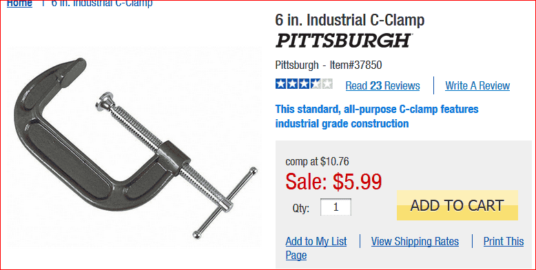

Berkeman had the right idea... reduce air gap and encourage flux to stay in it.Can you surround your iron bar with a magnetic path ?
6 inches is .15 meter
clamp your core and epoxy it in place at the fixed end . A small block of wood drilled to 3/32" will give you more glueing surface.
Now you have an adjustable air gap which gives you control of the the dominant L in your flux equation
