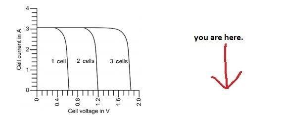

Your fans are probably failing because you typically have to do more with a solar circuit than just connect the panels to a load. A PV cell inside its operating range acts like a constant current source. Whatever voltage your system demands, the PV will deliver a fixed current. This holds until it hits its maximum power point (MPP). Then the current from the PV drops to 0 very quickly.
The picture (assuming it uploads properly) shows the problem. If your fan draws 5 or 12 volts, the PV supplies 0 amps and 0 power. If you get a fan for a voltages less than the MPP, it will work fine. Or you could create a circuit that forces the fan to only take a voltage less than the MPP. The 5 or 12 volt fan would operate in a diminished capacity, but it would work (at least most low power fans would). The concept of circuitry that keeps the voltage at the MPP to get the most power possible out of the cell is called Maximum Power Point Tracking
Also, if your panels really are 2 volts, then just adding another panel and putting all 3 in series should let you run the 5 volt fan perfectly.
