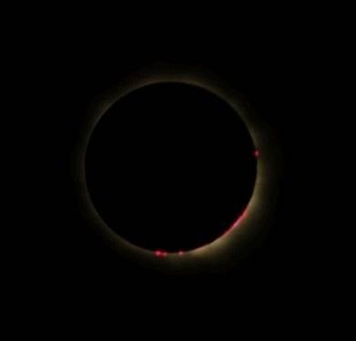

You are not likely to see much of it in visible light wavelengths
Prominences can sometimes be seen during total eclipses
from one of my eclipse photos, 4 small proms just visible

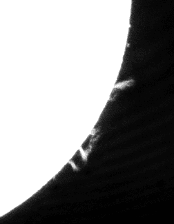

The image you linked to is ionised helium, He II
Much/most of it is easily visible if you have a hydrogen alpha solar scope like my
LUNT LS60 THa. It has a very narrowband H-alpha filter in it < 1 Angstrom specifically
to observe prominences
from that scope...

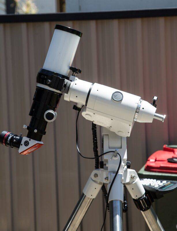

How much does a rig like yours cost these days?
The telescope with a B1200 blocking filter is AU$2500 (~ US$1800).
That tripod and mount (also used for several of my other scopes) is another ~ AU$1900 (~ US$1400)
Dave
