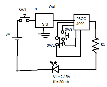

Why would a current regulator be needed? I had heard of them before in an example where somebody had multiple LED's in a series, but it doesn't seem necessary to my circuit to either increase battery life or make the system work. As for the steps you posted, unfortunately that is quite above my head for what I currently know; for instance I have never heard of a series inductor or what a half bridge is.
To better describe my circuit here is a basic schematic (poorly done in paint) to show what I am thinking for the circuit:
Your proposed circuit will be about 2.15V / 3.00V = 72% efficient.
All current including LED current flows through the linear regulator. That wastes energy in the regulator voltage drop. LED current then flows through R1 which wastes more energy.
LED and battery voltage will vary with temperature. The fixed value of R1 has little voltage drop after the regulator, so variations in LED forward voltage will cause variations in LED current.
A single MOSFET could protect your components from reversed battery polarity without significant voltage drop. Why do you need a voltage regulator?

The circuit I suggested is a switching converter that will do better than 95% efficiency.
If 70% is sufficient, then ignore the switching regulator. But if you want to screw the last 1% from the battery I would suggest a switching current regulator.

You want to think of the LED as a current driven device. The LED voltage is not stable (mostly temperature dependent). Also the I-V curve is quite non-linear at low currents. That is why @Baluncore was talking about a current source power supply and questioning your choices about voltage regulators. That is also why people often put a resistor in series with the LED if they are driving it from a constant voltage source. Look up the I-V relationship for diodes for a start. Also search for adjustable (dimmable) LED driver circuits. I'm sure there is an IC you can buy that will do most of the work you need.

The BCR402W is a "high-side current mirror" with a supply voltage overhead; VSmin = 1.2 volts. That says the supply must be 1.2 volts above the LED forward voltage, in order for the mirror to regulate the current.
With LED Vf of 2.15V, the supply must be at least; 2.15 + 1.2 = 3.35 volt.
The CR2032 has a voltage of 3.0 V, so a BCR402W will NOT be able to regulate the LED current.

Since you started this thread by asking about high efficiency, but then you were looking at linear current controller ICs, I think you need to understand a bit more about linear power supplies. In a linear power supply you define a current that you want to operate your LED at. Then you provide a power supply which provides enough voltage (let's call that Vcc) to operate the LED (Vd) plus some extra to allow the regulator to stabilized the current (this is a series voltage regulator, BTW. We'll ignore linear shut topologies since that's not a great fit here). The current through the regulator is the same as the LED current. Regardless of the type of linear current regulator, the efficiency of this circuit is Vd/Vcc. It doesn't matter if the regulator is a simple resistor or a transistor that is controlled by an IC. In a linear current regulator, it is the regulator's job to drop the excess voltage and create waste heat in the process. For low power LEDs this is almost always done with a simple resistor because it works well enough for most applications.
You have already determined that you don't want this inefficiency, that is why we have been talking about a switching power supply implementation. This is pretty uncommon for low power devices, so you may find it hard to find an IC that is advertised for just this niche. Most designers will use one of the many generic SMPS ICs to design their own SMPS current regulator. If you want to procced with a generic IC SMPS implementation, I would look at "current mode buck" control ICs. However, you will also want to study a bit about buck DC-DC converters to do this on your own.
Also be aware that the control IC will also consume some power. This can be negligible, or it could be significant depending on the IC you choose.

And my last question for now is again with the LED and current relationship. Say the current is the desired 20mA, but the voltage coming out of a driver is 4V and the drop across the LED is 2.15V. Would the wire immediately after the LED have a voltage of 1.85V? The LED does not have any harmful effects from having the excess voltage pass thru it because the current determines the voltage drop, correct? Lastly, say after that LED it goes to ground, there is no problem having 1.85V going to ground other than being waste?
anorlunda said:
Don't forget the more obvious ways to extend the life that can be simpler than an efficient power supply.
  1. Use a very low current LED. For the micro reflex sight application, not much light should be needed.
  2. Make sure that the LED is on only when needed. When mounted on a rifle, you could sense motion. If no motion is detected for say 90 seconds, turn the LED off. 4 years of micro reflex sight lifetime could mean as little as 100 minutes of LED on time.
The LED that is the likely candidate is: https://www.chips4light.com/assets/files/products/LA-HR09WP3.pdf. That only lower current LED's with that wavelength hit 5mA but has a tiny (30um) emission area and I am researching whether the light spread could even spread out fast enough (needs to be 114.7um for a reticle mask) to be usable. They smaller ones could work if I wanted say a 2.5MOA dot instead of the " ^ " shape I am aiming for.
The motion senser is an interesting idea, although a longer turn off time would be needed (25 minutes or so) because what if somebody decides to hold a crouched or prone angle for a long time? You never want the reticle going out during combat and I think 90 seconds is too low. This though could replace a power button and I could see consumers liking this feature (a lot of them like to leave theirs on at all times to be ready whenever); thanks for the idea!
DaveE said:
I would also add the commutating diode Schottky, in this case), but I wouldn't be surprised if you could get away with the body diode of the output stage for low frequencies.
Yes, an external schottky for protection, but the upper cmos transistor will be on when voltage is high, so it will conduct the freewheel current.
DaveE said:
The LED current will be determined by the diode equation.
The short on time, with the series inductor, limits the current via; V = L ⋅ di/dt;
DaveE said:
That is the maximum value for worst case analysis, not typical performance.
I always design for the worst case, or fully test components and select.
How else can I know the product will work every time.
I think we are thinking about different configurations. I assumed that the commutation occurs when the high-side FET is off and would flow (backwards) through the low-side FET.
No, that's not how the volt-second balance works on an inductor in a buck PS. For V=L⋅(di/dt) the voltage V is across the inductor V=Vcc-Vo, so the current slope di/dt=(Vcc-Vo)/L. The on time duration for fixed frequency PWM only determines how much the inductor current will change during that cycle. di/dt=0 , steady state, only occurs when D⋅Vcc=Vo (D is the duty cycle). The average voltage across the inductor must equal 0 in steady state or the average inductor current will change. This (to first order) has no dependence on the DC inductor current.
Yes, me too. That's what the people I worked for wanted. But we didn't sell our stuff on eBay or in Walmart. The truth is, lots of consumer products won't meet our design review standards. In our capitalist, consumer world there is a market niche for both.
Ozen said:
Just a few questions remain, mostly with setting up and operating the ADIM pin of the CAT3649.
No, I won't read and interpret the function of a complex IC for you (mostly because I don't know). That is why On Semi writes datasheets and other customer support documentation. Perhaps, after you search their web site, you could call one of their application engineers. I would be shocked if anyone here has experience with this special purpose IC. To use ICs like this you must do some research. Read every part of the data sheet first, then look for other supporting documentation.
BTW, in my (limited) experience ADIM is not a common digital interface.
The LEDs for this IC will be connected from the power supply to the IC output. So, for example, if your LED voltage drop is 1.6V and your power supply is 3.0V the voltage from the IC output to ground has to be 3.0-1.6=1.4V. It is the IC's job (based on your programming) to control the LED current as you asked by setting the correct voltage at it's output.
Another way of saying this is that the LED current will be whatever current is necessary to make the LED voltage drop equal the voltage that is applied across it by your circuit. Or, from a current driven perspective, the LED voltage drop is determined by the amount of LED current that your circuit makes flow through it. These are the same thing from two different perspectives.
I am certainly NOT suggesting fixed frequency PWM. I am saying a fixed width pulse will dump a standard charge through the inductor and LED. The average LED current will be proportional to the frequency of the software controlled pulse rate. That way you get efficient LED current conversion, and can adjust the brightness by changing the pulse rate. It eliminates current sense overhead inefficiency, and all those extra chips and components. That is why it is a minimalist solution.
Yes, I think that's a good approach. The user is the feedback mechanism.
