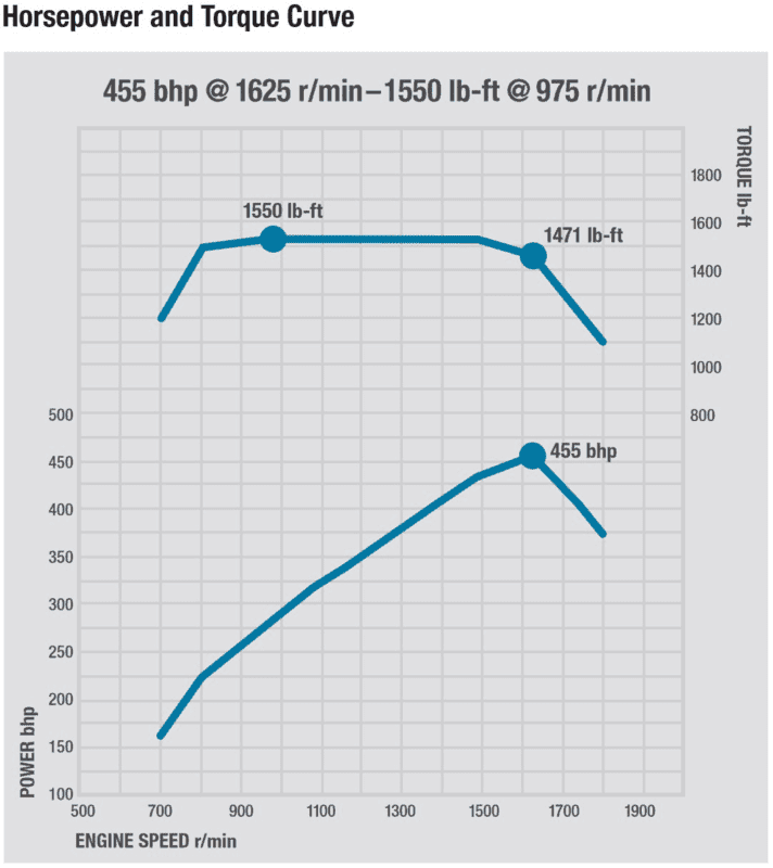

Most internal combustion engines are, at some level of approximation, constant torque devices. That is, over some range of speeds, the output torque is roughly constant. At the high end and low ends, the torque will drop off, of course. For constant torque, more RPM means more power. The power curve is what you get when you multiply torque by RPM. The power curve will peak somewhere to the right of the flat spot on the torque curve.
https://www.trucknews.com/wp-content/uploads/2020/01/DD15-THP-1.jpg
You use a transmission so that you can keep the engine RPM in a range that has near-peak power. Or near-peak efficiency -- or whatever metric you are after.
Likes Zalajbeg

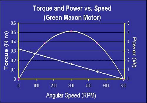

I believe that the torque curve for a typical DC motor is normally a straight line that starts with maximum torque at zero RPM and declines to zero torque at max RPM. A quick trip to Google confirms.
If you multiply torque by RPM, that means that you have a power curve like:
https://www.google.com/url?sa=i&url=http://lancet.mit.edu/motors/motors3.html&psig=AOvVaw3dGSkrtsVNG0bQj2Y2ODFf&ust=1585309918300000&source=images&cd=vfe&ved=0CAIQjRxqFwoTCPjlkOeJuOgCFQAAAAAdAAAAABAD
One could also derive an efficiency curve.
Likes Zalajbeg
