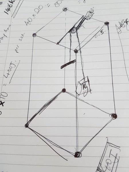

Hello Everyone,
I am an engineer and I wish to implement a gym system that generates energy from the user. I am originally an electrical engineer by trade, and have limited knowledge in mechanical design. This is why I need your help.
My current design follows the outline of a basic cable machine commonly found in gyms for exercising the triceps, biceps etc.
I have the brief design sorted:
  • A rectangular frame is used to support all the components and weights used
  • A pulley system is used to provide a means for the user to pull a weight up and down
  • The rotation of the pulley is transferred to a shaft
  • The shaft is connected to a motor
  • The motor is therefore run by the users energy
  • The output voltage of the motor is fed into electronics where the resulting energy is stored
I require advice upon the mechanical aspect of this project. I wish to make a system that is:
  • Efficient
  • Feasible to implement within 3 months
  • Can handle a weight of 10kg
Current component parameters are:
  • Motor with 15V rated output and 6mm diameter D-Shaped shaft
  • Frame material is 45mm-by-45mm Rexroth beams
I have provided some basic design sketches to give you a visual idea of what I am thinking:
The first image is the frame. It is 1 meter in height, and 0.5 meters in width and length. There is also a middle beam connected across the top as shown in the image.

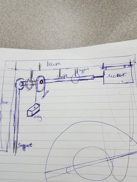

This middle beam is where the pulley and motor are connected, and is illustrated in the second image.
The second image is a basic representation of how I wish to connect the components together.
As shown in the second image, I wish to screw the motor under the middle beam, connect it to a coupling shaft, have the coupling shaft connect to the pulley, have the whole shaft supported by hook-like supports, and have the pulley rotate by having the cable pulled up and down by the user on one end and connected to a weight on the other.
Please give feedback on my design, and I need better ideas so I can improve the project.
Can we back up a sec? What is the purpose of this project? Is it for school? An invention for commercialization?
Have you considered;
How much energy is available to be harnessed?
How harnessing it will affect the workout you get?

As in a senior design project? Or is this a lower level? Is it individual or are you part of a team? In either case, just as a demonstration that it can be done, the project idea is fine. For such a project, the idea doesn't need to be comericially feasible...though you will want to examine that when you present it and write a report about it.
There are a lot of details to be worked out and I'm not sure if you know what they are or not, but there is a fundamental problem: your design has a 10kg weight in it. Your weightlifter can either lift a 10kg weight *or* he can spin a motor to generate energy, simulating a 10kg weight. But he can't do both. This means your weightlifter only gets the benefit of lifting the "weight", but doesn't get the benfit of lowering it (the bar will lower itself via gravity). Is he going to be ok with that? It also means your energy extraction is half what you calculated. Continuing the thought:
The equipment will be made in such a way that it will not affect the functionality and movement patterns of the original equipment. This is done to allow for the gym users to not notice any difference in usability, and keep the effect on the muscles similar.
Conservation of energy tells us that you only get to use the energy once. You can either use it to lift a weight or you can use it to spin a generator, but you can't do both. It almost sounds like you think the electricity is generated for free, with no torque on the motor/generator. This means that the person doing the weightlifting is going to notice the difference.
This also beggs the question: what did you think the motor/generator is acutally doing? Volts, amps, rpm, torque? I think if you look into selecting the motor as your starting point and looking at how exactly you extract energy from it, that will tell you a lot of what you need to know in terms of what the mechanical design will need to look like (pulley/gear ratios and such). That part really isn't difficult (you probably took an introductory physics course already...?).
I feel like I should be disappointed that an engineering student is missing something so fundamental, but I think this is why design projects are so critical; this is wha happens when an electrical engineer looks at amps and volts and doesn't think about what that means in terms of RPM and torque...and vice versa for the mechanical engineer.

Designated design parameters before are a no no - you are restricting yourself already.
In other words, what you have classified as being the "current component parameters" may not be a good fit after the analysis of the system nor fulfill the expectations of the new design ( those starting with "efficient, ... )
I agree but since it is a school project those restrictions may be valid - i.e. it may be all that he has access to without pouring money into the project.
