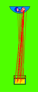

I am ok that you can see the source emission with vised, but if you want to "see" the particles transport and the interaction from the source to your INa detector you must put something like:
PTRAC write=all file=asc max=1000 cell=37
I tried your file with this line and moritz and it seams to be ok,
PSR
With your file and the PTRAC line It gives this type of image

yes, first you run MCNP with the line PTRAC I give you. A file "ptrac" is created. I read this file with "moritz". I think that it is possible to read a ptrac file with "vised". You must have something like :
read a ptrac file,
read a track file,
I don't know vised but with moritz it is:
file-> Read-> read particle tracks
hope this helps

Hi,
it gives that (ptrad.txt), with Moritz (not free)
but I think it is possible with vised

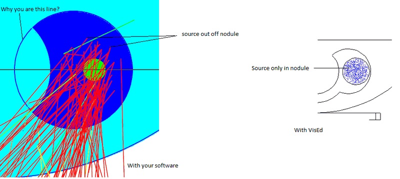

Hi,
thank you for your answer but your plot shows that the source is out off the nodule whereas the source is only on the nodule. In the distribution, we have 100% in the nodule and nothing out off (see TestPlot). Why the particle doesn't exist in y direction with your plot? If you change the ration uptake in nodule (70%) and 30% in out off (see MCNPCodeD70), how the transport become?
I can't buy Moritz.
Thank you.

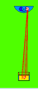

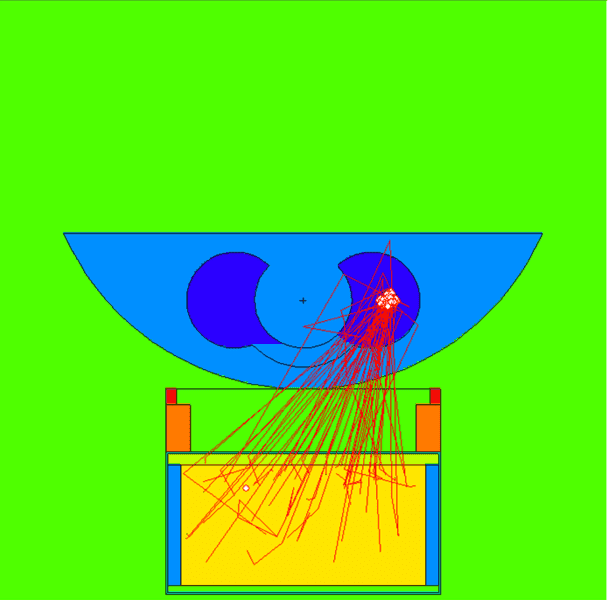

ok, I understand my mistake,
I wrote
SI1 L 30 31
SP1 0.2 0.8
instead of
SI1 L 30 31
SP1 0 1
For y direction it's because I calculated only the tracks with a contribution in the tally
"with a contribution in the tally" it comes:
and for all the tracks it comes :
that's all folks
