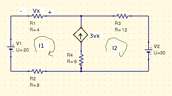

Given the following circuit using mesh's method to solve for the power of the dependent source.
Using the same circuit and using the node voltage method solve for the power of the dependent source.
Circuit:
Noting that I have to implement a super mesh for the dependent source to solve the unknown currents. I have arrived to the following equations
[itex]Vx = 4I_1[/itex]
[itex]3Vx = I_2 - I_1[/itex]
The Mesh equation:
[itex]-4I_1-12I_2+30-8I_1-20 = 0[/itex]

By solving the mesh equations for [itex]I_1 = \frac{10}{12} - I_2[/itex]
I have arrived at the following solutions
[itex]I_1 = \frac{5}{84}[/itex]
[itex]I_2 = \frac{65}{84}[/itex]
[itex]Vx = \frac{5}{21}[/itex]
[itex]3Vx = \frac{5}{7}[/itex]
Checking by Kirchoff's voltage law to see if all voltages within the outter loop it does equate to 0.
I need a check to see if this is right and I have no idea how to properly implement the node voltage method because the equations do not seem to come out right. I think my trouble is properly putting the correct polarity/sign convention of all devices

Well I am not entirely sure if my sign convention for all devices is correct. And which or how many nodes to pick when implementing the node method and what to use when using KCL for node for the middle branch, would I just put the current down that branch as 3Vx, and I just want to see if my first solutions using Mesh is correct

On your KVL work, I'm not sure I understand why you wrote an equation around the whole outside loop, instead of writing the 2 equations for the left and right loops. Also, be sure to label the +/- assumed voltage drop direction on R3, so you can keep it consistent in later equations.
For the KCL, I would put ground at the bottom of R4, and write equations for nodes on each side of the V1 source, and the top node at the top end of the dependent current source.

You've got a sign error here:
The Mesh equation:
It should be:
[itex]-4I_1-12I_2-30-8I_1+20 = 0[/itex]
And you have a sign error here:
You should have:
[itex]Vx = -4I_1[/itex]
Combine them to get:
[itex]-12I_1 = I_2 - I_1[/itex]
Now if you solve your simultaneous equations, you should get:
I1 = 1/12
I2 = -11/12
From which the voltage at the top middle node = 19 volts, assuming the bottom of R4 is the reference, or ground.
For the nodal method, I would move R2 to a position between R1 and the middle node; then the negative terminal of V1 is grounded and the whole thing is easier to conceptualize.

I always have a problem with getting the right sign convention here, I've been working on this for multiple hours trying to find a comprehendable explainable solution to my mess. Being that the original direction gets confused with the direction I am trying to take. How do you know which convention of the device is correct, I can never seem to get them correct. Also one minor detail left.
To find the power of the dependent source can I simply use the fact that
[itex]P_ds = I^2R[/itex]
Which R is the resistance of 6 ohms

You know the current in R4, so you can calculate the voltage across R4. Then the voltage across the dependent source is (19 - voltage across R4). Then the power delivered by the dependent source is (voltage across the source)*(current through the source).
I got -1A for the current dependent source, does that seem right?
