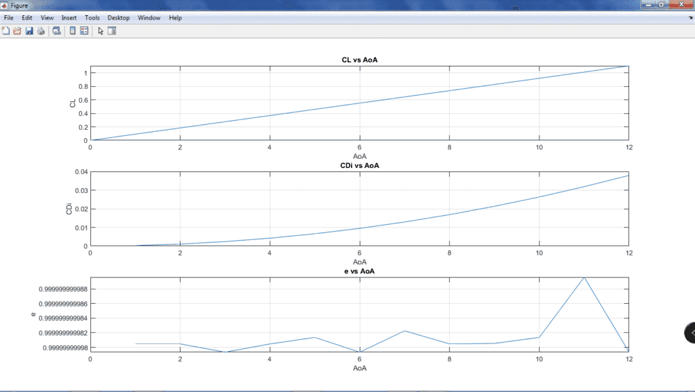

Need help with this lift-line theory application
In summary, the conversation discusses the concept of angle of attack and its importance in the AOA. It also mentions finding motivation to exercise regularly and offers tips such as finding enjoyable forms of exercise, setting achievable goals, and being kind to oneself.
angel1601
TL;DR Summary
I'm calculating the lift coefficient of an elliptical wing while i'm changing the values of AoA. Then, i'm doing an CL vs AoA plot, but here it shows a straight line and i read that it's supposed to stall in one point, but it's not happening here. What can I do? Or how can i interpret this result?
Welcome, angel1601! :smile:
The AOA should increase the value of CL, but only until the critical AOA (maximum value is reached).
The critical angle is normally found for a specific wing via experimentation.
Please, see:
https://en.m.wikipedia.org/wiki/Angle_of_attack
:cool:
