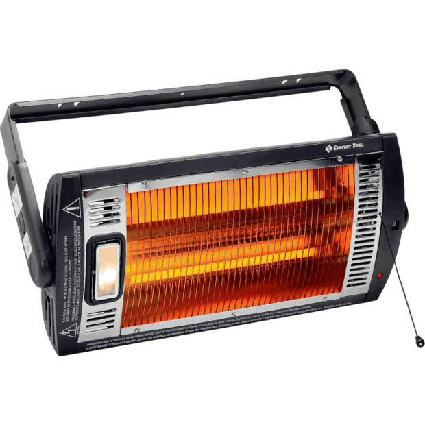

As temperatures get up, tungsten heaters in halogen with quartz glass such as below or other more expensive alloys for kilns.
