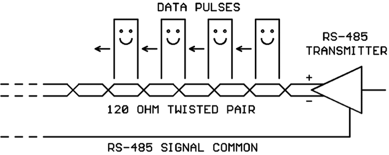

I am measuring a communications bus with an oscilloscope at various points along the line. I understand that there will be reflections at each stub as well as at the ends of the bus if the impedance doesn't match. I also understand that these reflected signals will add/subtract with the incident signal as well as change its phase. If I am interested in observing the resultant wave, does it matter where my oscilloscope is located in relation to the transmitter or ends of the lines?
For example, if I measure a 150-foot bus at 3 locations:
1) Immediately next to the transmitter at one extreme end of the bus
2) In the middle of the bus (at the 75 foot location)
3) At the extreme end of the bus opposite the transmitter
Will the waveforms look the same? The symbol rate is 1 MHz.
Thanks for any help.

No. If you have a standard transmission line (not multidrop), the state of the signal at the end of the line is what matters. If you cannot decipher the signal with an oscilloscope there, you cannot expect a line receiver to do it.
I am somewhat surprised about 78Ω, however. I know about coaxial cable at 50Ω (RG-58) and 75Ω (RG-59) and twisted pair (100Ω to 120Ω). What kind of cable do you use?

Place the oscilloscope at the far end of the line.
If the oscilloscope has a 50 ohm input impedance, connect it through a 27 ohm series resistor, (close enough to 28 ohm), to the end of the line. That will terminate the line by making it look like 50 + 27 = 77 ohms. There will be a 50/77 signal attenuation seen on the oscilloscope due to the termination.
If the oscilloscope is high impedance, use a T connector on the front of the oscilloscope, with the line on one side and the termination on the other. That will minimise reflections.
Do you have a 75 ohm T connector?
Take care when mixing 50 and 75 ohm connectors that look much the same. They can damage each other due to slight differences.
If possible use a 'T', 'Pi' or 'L' attenuator to convert between the 50 and 78 ohm worlds.

The line is terminated with a 78 ohm resistor when I measure at the stubs along the line. When I measure at the end of the line, I remove the terminating resistor and plug it directly into the 50 ohm scope. Would this (goo.gl/YlikNS) 75-to-50 ohm connector be a good choice to interface to match the line/scope impedances?
CWatters said:
Does that mean you have multiple receivers along the line?
Yes, I have multiple receivers along the line. I would like to look at the signal at each receiver/stub and at the end of the line to see if they are all receiving the same signal. I thought the reflections might affect the signal integrity depending on where I measured.

Oops - if you attach stubs to a transmission line, you get all kinds of reflections. On a multidrop line, the "stubs" should preferably be less than 5mm.

You are using twinaxial cable, not coaxial cable. Coaxial adapters will not help you.
