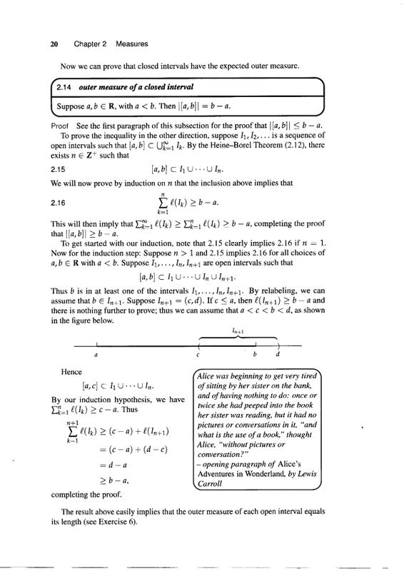

I am reading Sheldon Axler's book: Measure, Integration & Real Analysis ... and I am focused on Chapter 2: Measures ...
I need further help with the proof of Result 2.14 ...
Result 2.14 and its proof read as follows
In the above proof by Axler we read the following:
" ... ... To get started with the induction, note that 2.15 clearly implies 2.16 if ##n = 1## ... "Can someone please demonstrate rigorously that 2.15 clearly implies 2.16 if ##n = 1## ...
... in other words, demonstrate rigorously that ##[a, b] \subset I_1 \Longrightarrow l(I_1) \geq b - a## ...My thoughts ... we should be able to use ##(a, b) \subset [a, b]## and the fact that if ##A \subset B## then ##\mid A \mid \leq \mid B \mid## ... ... but we may have to prove rigorously that ##\mid (a, b) \mid = b - a ## but how do we express this proof ...Help will be much appreciated ... ...

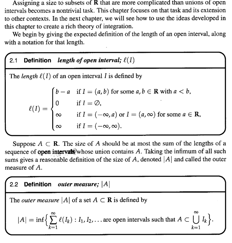

Readers of the above post may be assisted by access to Axler's definition of the length of an open interval and his definition of outer measure ... so I am providing access to the relevant text ... as follows:
Hope that helps ...
Peter
You start with ##[a,b]\subseteq I_1##. Write ##I_1=]c,d[##. Then ##l(I_1)= d-c\geq b-a##. Not sure if that solves your problem?

Axler defined the length ##l## only for open intervals, so it does not make sense to ask what ##l([a,b])## is without giving an appropriate definition.
You proved that ##|[a,b]| = b-a##. Similarly, you can prove that ##|(a,b)| = b-a##. So when you will continue reading, you will note that the function ##A \mapsto |A|## restricted to "good" subsets has properties you want a length to have. So actually what you are doing is constructing a measure on some collection of subsets of the reals such that it extends the length of the open interval ##(a,b)## in an intuitive and good way. Hope this helps.
