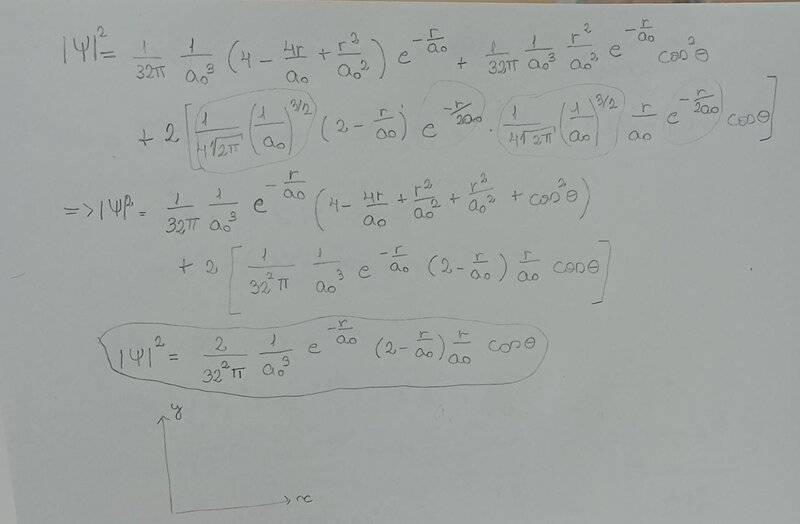

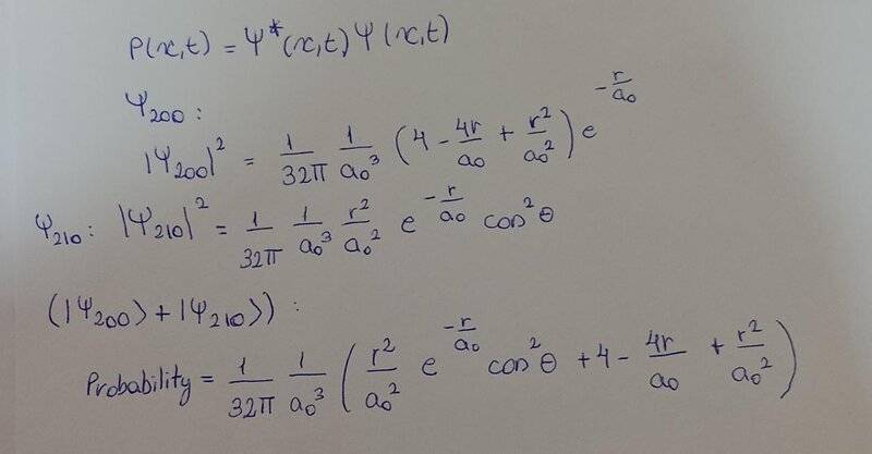

Consider a superposition state |Ψ⟩ = (|2, 0, 0⟩ + |2, 1, 0⟩) of the hydrogen atom.
a) Calculate the probability density at t = 0 and sketch the function in the (xy) plane.
b) Calculate ⟨Ψ|r|Ψ⟩ and mark on the graph the expected value of the position obtained in part (a). Interpret your result.
I'm not certain about the equations
I did this and I don't know if it's correct:

So sorry, now i tried to include my attempt.

If ##\psi = \psi_1 + \psi_2##. Which of these is correct?
$$|\psi|^2 = |\psi_1|^2 + |\psi_2|^2$$$$|\psi|^2 = (\psi_1 + \psi_2)(\psi_1^* + \psi_2^*) = |\psi_1|^2 + |\psi_2|^2 + \psi_1\psi_2^* + \psi_2 \psi_1^* $$

the second one...
in this case ψ_1=ψ*_1 (and the same for ψ_2)?
wakaranai said:
the second one...
Yes, those particular wave functions are real-valued.
Note also that the wave-function you have been given is not normalised:
That wavefunction has a modulus squared of ##2##. I would have expected:
$$\ket \psi = \frac 1 {\sqrt 2}\big (\ket {2,0,0} + \ket {2,1,0} \big )$$

I don't know how to relate the result with the plot in xy plane
You seem to have got a lot of simplification for your final answer. Are you sure about that? I would expect the result to be messy.
Note that, in the x-y plane, we have ##\cos \theta = 0##. That should simplify things. Even so, sketching that function wouldn't be easy!

So |Ψ|^2 = |Ψ_1|^2
wakaranai said:
So |Ψ|^2 = |Ψ_1|^2
Looks like it.
