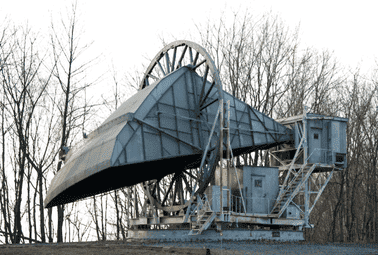

It is very much bigger than that and it doesn't have a diameter as such ... it is basically rectangular with a slightly curved surface 6.1m at it's longest length
The antenna is 50 feet (15 m) in length with a radiating aperture of 20 by 20 feet (6 by 6 m) and is constructed of aluminium.
all this info was in the links in your original post

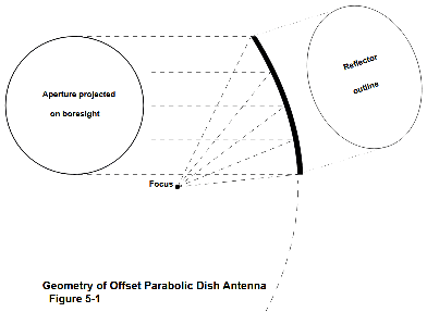

As noted by Sophi and myself , that is pretty much all incorrect
It is the directionality of this component that makes it possible for the apparatus as a whole to avoid the thermal noise from the 290 K radiation from the aluminum of the horn
please read carefully ... getting frustrated having to constantly repeat myself
Thermal radiation from the horn material is so low that it is basically irrelevant .. I have given you links to that several times
The metal sides of the horn SHIELD THE ANTENNA from the thermal radiation from the groundDave

I am sorry that I misunderstand what I have read.
https://www.revolvy.com/main/index.php?s=Holmdel Horn Antenna&item_type=topic
The reflector is a segment of a parabolic reflector, so the antenna is really a parabolic antenna which is fed off-axis. A Hogg horn combines several characteristics useful for radio astronomy. It is extremely broad-band, has calculable aperture efficiency, and the walls of the horn shield it from radiation coming from angles outside the main beam axis. The back and side lobes are therefore so minimal that scarcely any thermal energy is received from the ground. Consequently, it is an ideal radio telescope for accurate measurements of low levels of weak background radiation. The antenna has a gain of about 43.3 dBi and a beamwidth of about 1.5° at 2.39 GHz and an aperture efficiency of 76%.
The underlining is mine.
From this text I decided that I could determine the radius of the "parabolic antenna". In my post #36 I showed the calculation of a parabolic telescope diameter (1 m) from the other data I had. I also used another formula for determining the beamwidth.
Using the value ψ=1.5o I calculated D = 88 cm.
I am completely baffled about why this is wrong.
Regards,
Buzz
because you used 1 metre instead of 6 metres
and you didn't underline the important sentence that tells you what I have been trying to impress upon you several times
read the bolded bit ... it gives you the result of the effectiveness of the horn as commented on in the previous sentence that you did underline :smile:

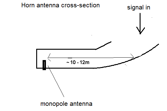

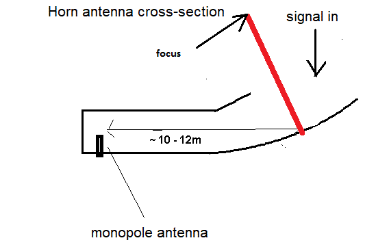

In yout post #36, you indicate that the "antenna" is in the "shed" attached to the small left end of the horn. Perhaps the shed also houses the 1 m diameter parabolic reflector. If not, what is the means by which the CMB signal reaches the "antenna" if there is a 6 m by 6 m reflector?
absolutely and utterly definitely NOT
it reflects off the reflector that you can see at the opening and is funnelled down the horn to the antenna element
it really is as simple as that ... I showed you a basic horn antenna way earlier on in the thread
stick a reflector at around 45 deg angle at the open end of the horn

  • #49
basic cross section drawing of the Holmdel antenna ( not to scale)
the actual horn and reflector showing the reflector surface ... lines are dotted where the surface is hidden by the front part of the horn panelling
Look at the shaded/outlined area compared to the size of the two guys ... the reflector area is HUGE ... it ISNT 1m x 1m
Dave

  • #56
Buzz Bloom said:
I am curious about the distance from the focus to the shaped surface point where horn the axis intersects the curved shape. Would this be the same distance if the target and the focus were along the same axis, rather than at an angle?
still trying to decipher what you mean ??
comparing the length to the two guys guestimating approx 10 - 12m from the centre of the parabola reflector to the antenna
is that what you are asking ?
if it was a direct path, then there would be no parabola and as a result there would be no focus
D

Hi Dave:
On the figure below the red line is the axis of the parabola. The top end of the red line is the focus of the parabola with respect to rays moving parallel to the red axis. My question is a mathematical one about a property of parabolas. Is the distance (a) from the focus at the end of the red line to the center of the parabola, the same distance as (b) the estimated 10-12 m of the offset focus for rays moving vertically downward in the diagram?
Another question: The photograph in post #22 shows the monopole antenna in the shed rather than inside the horn. Is this correct? Or does the horn continue into the shed, and the monopole is inside the end of the horn?
Regards,
Buzz

  • #62
No this is incorrect
It would be incorrect IF it was a normal full dish antenna
Go read up on offset fed dish antennas ... there's lots of ray diagrams and info on the net
You really start need to read up on this stuff.
it's inside the horn, right at the end of the horn as I drew in my diagram (which is inside the shed)

Hi Dave:
Thank you for mentioning "offset fed dish antennas". I found several articles that I was unable to find without knowing the proper vocabulary.
The third one had a particularly useful picture.
The term "offset paraboloid" in the last post from @sophiecentaur was also helpful, although he was mistaken that the term had been in a previous post. (I could not find it by searching through all the thread pages. I also could not find the reference he referred to as "iirc".)
The reason I asked you about the equality of focal lengths from different angles was because my intuition told me that they should be different, and also that the cross sections of the offset dish would be elliptical rather than circular. I tried to confirm this by doing the math, but it was to difficult for me. I was able to deduce that the focal length F for a circular parabolic dish was
F = 1/(4a),​
where the parabola is defined by
y = a x2.​
Unfortunately that was as far as I could take the math.
Thank you again for all your help and for your patience.
ADDED
Here is a better photo of the Holmdel. It is much clearer to see its geometry.
Regards,
