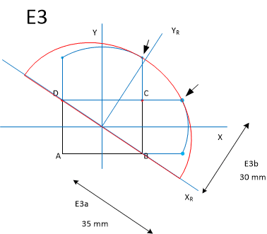

With your choice of variables the rectangle has corner points ##(\pm{a\over 2},\pm{b\over 2})##.
The string is tight along three sides for the part you have already figured out: ellipses (ellipse sections) with center ##(0,\pm{b\over 2})## and ##(\pm{a\over 2},0)##. Focal points are adjacent points on the rectangle.
In the corners the string is tight along two sides and you get ellipses with focal points on diagonally opposite points.

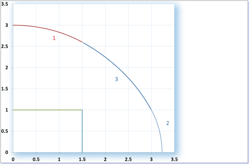

Managed to fumble the three ellipses in Excel ?:)
Main headache was variable naming (your ##a## and ##b## versus theirs) :smile:
And, of course, the almost unavoidable chaotic Excel unstructured programming.
For what it's worth I added the ?:)

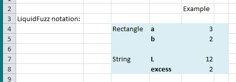

I'm not sure I follow your calculations BVU. Is it what I'm looking for..?
I attached the excel I tried the calculations in. There you can see the segments I still haven't got, the corners. Oh, I should mention that I used Libreoffice for this tinkering.
Edit, these spread sheets are a bit sluggish, so it is not possible to change the number of data-point. However, it was fairly easy to plot the equations to see how they held up.
  • ellipsish shape.xlsx

In #10 I only bothered for one quadrant. My example has a relatively large ##e## so the corner section is large too and I was able to check for a few points with a ruler.

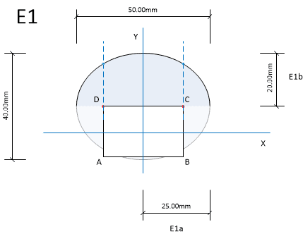

Did you understand post #4 ?
Does this help for the top ellipse section in my example ?
C and D are the focal points at ##(\pm {a\over 2}, {b\over 2})##. The ellipse section has equation $$\left (x\over E1a\right )^2+ \left (y- b/2\over E1b\right )^2 = 1\ ,$$valid between the blue points (above C and D), so for ##{a\over 2}\le x \le {a\over 2}##.
If this is clearing it up for you, I can try to add E2 and E3.

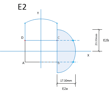

(Currently having fun with Visio to draw the corner ellipse). E2:
The E2a =17.3 mm is actually ##\sqrt 3##. Ellipse equation between the blue points straightforward$$
\left (x-a/2\over E2a\right )^2+ \left (y\over E2b\right )^2 = 1\ ,$$
Sorry about switching from cm to mm. Visio thing.
Genuine ellipses ! Corner section between the arrows.

I tried your excel-file and it crashes as soon as I edit length, width, and string length. :-/
My don't crash so I stick with the analytical solution for now. I think I'll just go with brute force for the corners, when I have some spare time.
Yes, it's not a production version :smile: : No error handling for a < b for example, let alone dealing with that.
But it's straightforward, so once you understand it, it can still be useful.
