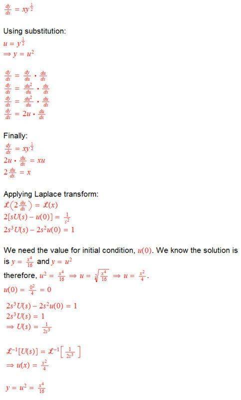

But ##\frac{du^2}{dx} = \frac{du^2}{du}\frac{du}{dx} = 2u\frac{du}{dx}## using the chain rule. This leads to a very simple, linear DE that you can use Laplace transforms on if you must, but much simpler techniques can be used.

Thank you!
I was able to solve it. So, I'd say that saying that a nonlinear differential equation cannot be solved using Laplace transform is not a correct statement.
Note to self:
"y" is expressed in terms of "u", or as a function of "u". "u" in turn being function of "x". "y" is still a function of "x" but to make things easier we introduced substitution variable, u, and it stands between "y" and "x"; in other words, "y" depends upon "u" and "u" depends upon "x".
y=u^2
dy/dx=dy/du * du/dx
dy/dx=du^2/du * du/dx
