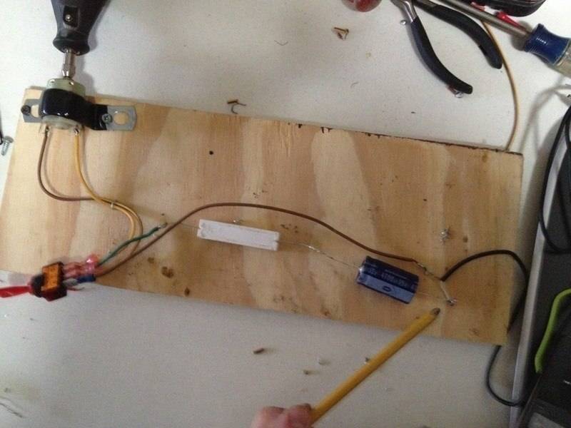

I'm having issues with this simple circuit. If you look in the top left corner of the image attached, I have a dremel tool powering an 18vdc motor which puts out current at 1.96 amps. Then it goes to a switch. The wires then go to an 8 ohm resistor(white rectangle) then to a 4700μF capacitor(blue cylinder). Now where the pencil is in the picture, I still have 18 volts being regulated by the capacitor. Where I have soldered the ground wire from the switch and the hotwire to the capacitor I still get 18 volts. There is a connector at the end of the black wire at the bottom right that plugs into a universal powermat, and I cannot get 18 v out of the end to power the mat. Can anyone help me?

You seem to have a DC motor with a capacitor and a resistor in series with it, fed from an 18 V DC supply.
Capacitors do not pass DC, so the motor will not work like that.
So, you can remove the capacitor (replace it with a piece of wire) and try again.
It did not work. I know the specs require 18 v at 1 amp to power the charge mat, and the motor is 18v at 1.96 amps. I have used an 8 ohm resistor and a 10 ohm resistor as well, any other suggestions?
If I'm reading this right, vk6kro seemed to be hinting that you need the capacitor in parallel with the load, not in series. I'd agree with him.
The capacitor is a filter. Put it *between* the V+ and return line, and it blocks DC from shorting to ground, but allows the ac component to bleed to ground (=stabler DC). If you put it *in* the return line, it blocks all DC current from going through the circuit (but you'd still read a V+ *potential* as you noted)
The most important function of the resistor is to prevent an initial short-circuit through the capacitor as it charges. That would burn out your generator motor.

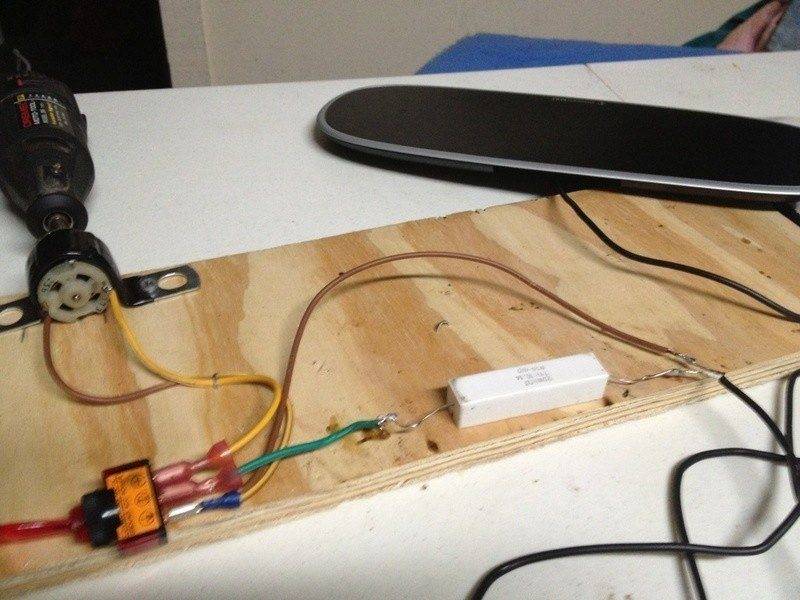

Here's a closeup of it redone

Here's the closeup in parallel

The capacitor is still wrong.
It should go across the output, ie from the centre of the output wire to the shield of the output wire.
Note that the + sign on the capacitor has to go to the + side of the supply.

Centaur,I thought by soldering the resistor and capacitor at the same point makes it in parallel?
Sorry, the last picture has them in parallel. But are you sure you have the capacitor connected the right way round? I can't tell, from the picture, which is positive and which is negative but the capacitor mustn't be connected the wrong way round. What's it there for anyway?

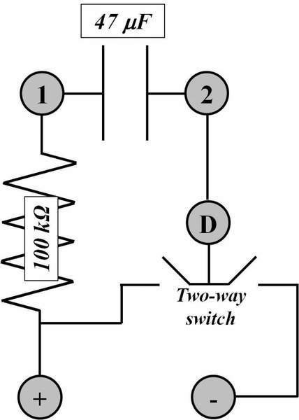

The motor does slow down audibly, I noticed that a few days ago, I also need to place the switch after the capacitor and resistor. I believe that the current will fluctuate, so having the capacitor drain and power the mat steadily is my goal. However, I am not quite sure how long(if it even can) the capacitor can support the mat. But the capacitor is 4700μF and the resistor is 8 ohms. I have tried series and parallel and it seems the paralle works best.

The diagram doesn't include where you have connected the heat mat (fairly important). Also, the two way switch would appear to apply a short circuit to the motor output if you put both contacts the other way. Have another look and try to improve the circuit diagram. We could be almost there!
Also, it's nice that the motor slows down. That implies some power is being generated and dissipated (somewhere). Does the resistor get hot?
That 100k resistor is much too high to achieve anything, btw.
