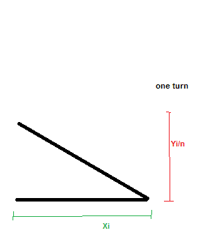

Are you seeing this as something like this?
If so i don't understand why pi*xi and not xi
A helix defines a cylinder that has a diameter and a circumference = Pi * diameter.
One turn of the wire spring advances yi/n.
The circumference of the helix is Pi*xi.
The length of one turn of the wire is Sqrt( ( yi/n)^2 + ( Pi*xi)^2)
If you compress the spring from axial length yi to y without changing n or the wire length then;
Sqrt( ( y/n)^2 + ( Pi*x)^2) = Sqrt( ( yi/n)^2 + ( Pi*xi)^2)
Likes 1 person
