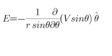

Raihan amin said:
Now put these value in the Original equation,and you are done.
$$V(\theta) = V_{0} \frac{ln(tan(\frac{\theta}{2}))}{ln(tan(\frac{\alpha}{2}))}$$??
Now using this formula,you can find E too.
