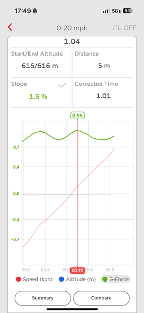

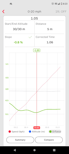

If there were no counterweight and stable acceleration were achieved by setting an initial forward lean angle, would there be any further acceleration to be gained by using a counterweight in addition to the forward lean angle?
  • #50
The reason I ask is some electric skateboard riders showed me they are getting around 1g acceleration from leaning alone…
  • #51
You can get arbitrarily high acceleration by leaning alone. Take the arc tangent of the horizontal acceleration in g's. The acceleration in g's is also the required coefficient of friction.
A drag racer can pull 5 g's. The arc tangent of 5 is around 79 degrees. If you measured the angle from the contact patch under the rear tires to the center of gravity, it would need to be under 12 degrees from the horizontal. [Ignoring aerodynamic effects]
You say that a skater can pull over 1 g. The arc tangent of 1 is 45 degrees. So the lean angle will be over 45 degrees from the vertical. You measure that angle from the contact patch under the skateboard to the position of the center of gravity of the skater plus counterweight.
If a motorcycle can corner at 2 g's then the lean angle will be 64 degrees from the vertical. You measure that angle from the contact patch to the center of gravity of rider plus bike. [Ignoring gyroscopic effects]
