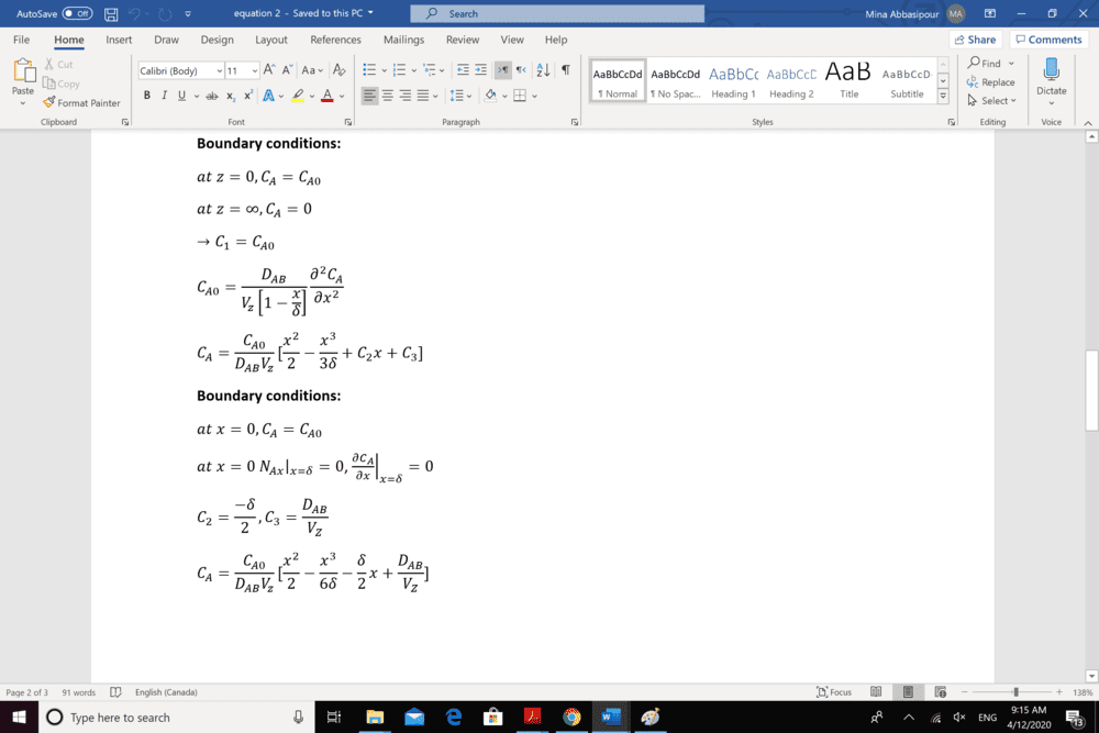

Hello everyone,
I would like to obtain the equation for mass transfer of contaminant in a river. Here the fluid flow is laminar and I don't have reaction. I solved it and obtained this equation, but I think this equation is wrong because when I solved it numerically I got wrong answers. Would you please help?
Thanks a lot

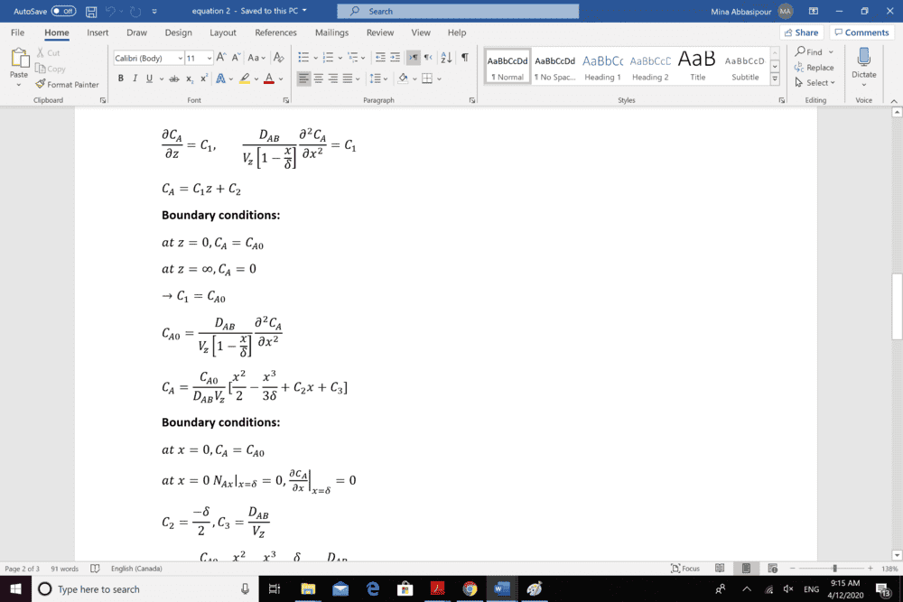

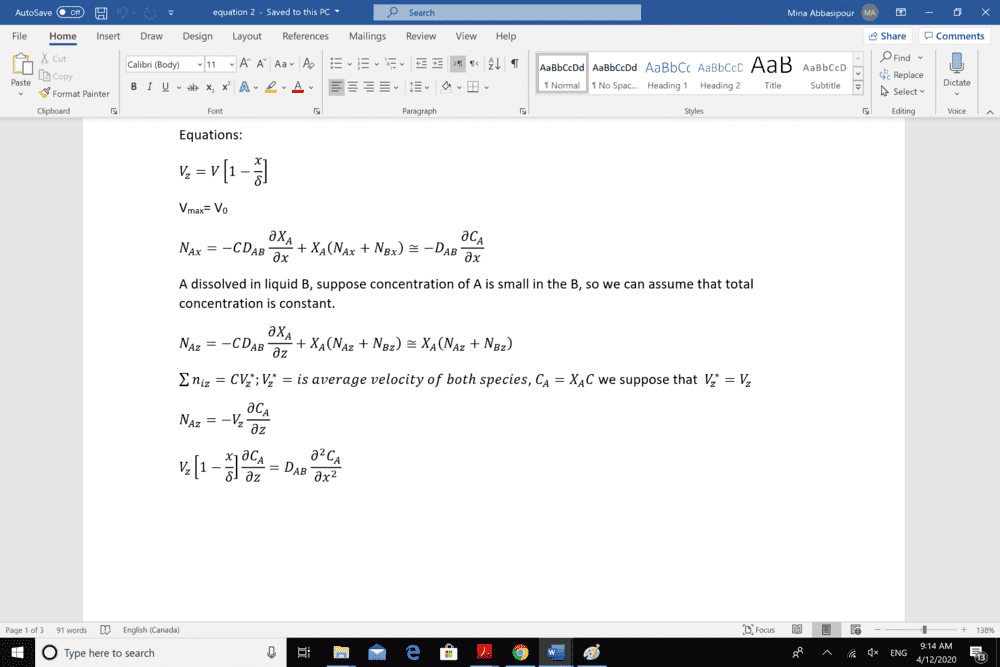

Thank you for comment. Here is screen shots:

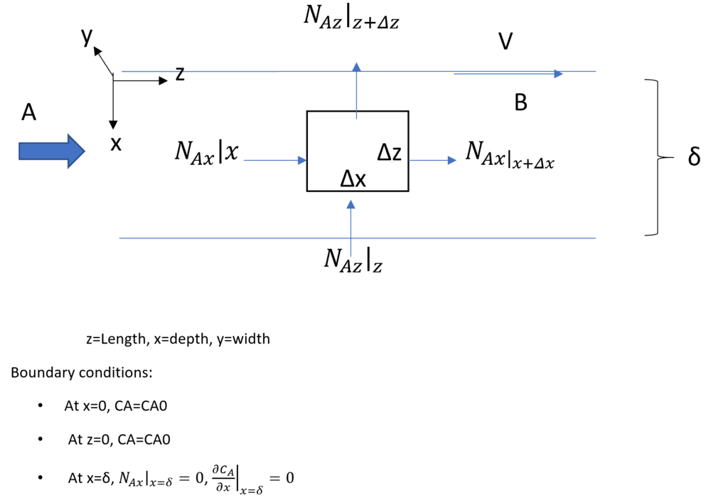

Thank you so much for your reply. I try to obtain mass transfer of contaminants in a river. I suppose that my problem is laminar flow and I don't have reaction. I suppose that (A= contaminate particles, B=water)
X= depth, Z= length and Y= width of river
Boundary conditions: at x=0 , Z=0 CA=CA0 and at Z=delta (depth of river) dCA/dx=0
Vz= V(1-x/delta)
Vz(1-x/delta)dCA/dz= -DAB (d^2CA/dx^2)
I don't know my way is correct or not and if it is correct how should I continue it?

I see the equations you are trying to solve and understand the physical problem you are trying to solve. Your formulation looks OK to me. But your solution method to this set of partial differential equations in x and z (as presented in the screen shots) is totally incorrect. You also alluded to a numerical solution. Is that different from what is shown in the screen shots? The solution to the partial differential equation and boundary conditions you formulated is ##C(x,z)=C_{A0}##.

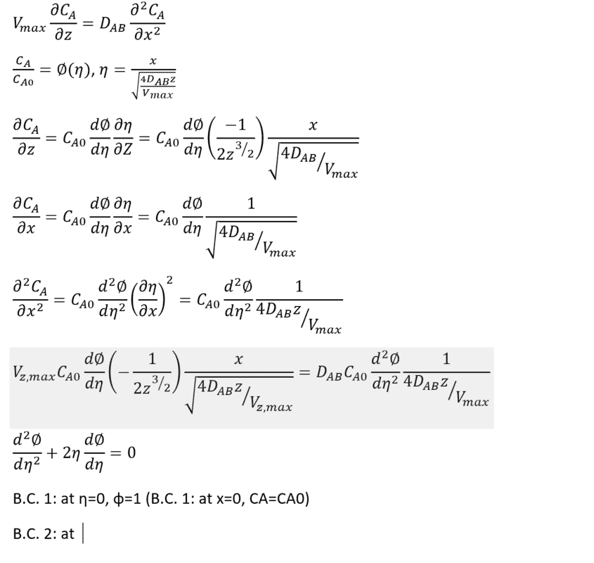

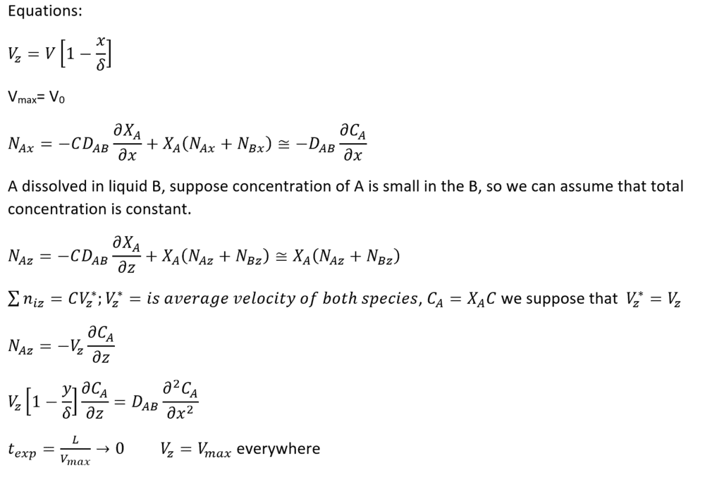

Today I solved them in another way. I suppose that Vz=Vz, max and solved the equation. But now the obtained results were completely different with Comsol simulation. I don't know where is my problem.
Maybe you want the BC at z = 0 to be C = 0?
I supposed that where the contaminant is pouring in the river is X=0 and Z=0
Then in your steady state formulation, it is going to propagate downstream and fill the entire region. Check it out. Substitute ##C(x,z)=C_{A0}## in your differential equation and BCs. You will find that it satisfies them exactly. And, since the equations are linear, it is the unique solution.

What I am saying is that the solution to your equations as formulates is ##C(x,z)=C_{A0}##. Your differential equation is OK, but there is a problem with how you are specifying the boundary conditions. The correct formulation depends on the precise details of what is happening at the boundaries in the actual physical system. The boundary conditions you have specified does not capture the essence of what is happening at the boundaries in the actual physical system you are trying to describe.

As I said, it depends on the details of the actual physical system. Also, maybe you want to be looking at the transient behavior of the system, rather then the steady state behavior?

In real system it is not steady state and it is turbulent. But I can solve it simply, I suppose that it is laminar and steady state.
The thing that is causing the problem with your analysis is the boundary condition at z = 0. As long as it is ##C_{A0}##, it is going to be that value throughout the solution domain at steady state. You just can't have the entire stream flowing into the region at that concentration. Try the calculation with this value set to zero, just to see how the solution comes out.
