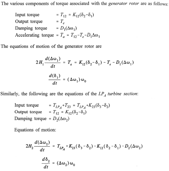

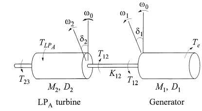

I have the following system I got from a book, which models the dynamics of two masses connected by a shaft.
The system is given below:
And the equations given in the book for this system is below:
The nominal speed is w0.
And the interest here is the deviations from the nominal for mass 1 (Δw1) and mass 2 (Δw2).
I understand all the equations except for the ones below:
How does it make sense that the rate of change of the angle equates to the deviation in speed for that mass times the nominal speed?

I can't answer your question, but just judging by the notations involved, I'd guess that you got this from an EE textbook. The generally make a hash of rotor dynamics. By the time everything is expressed in "per unit," nothing makes sense anymore.
bc331d30-a574-408f-ba6c-0a3d7a71e20b
Quite - it makes no sense dimensionally.
