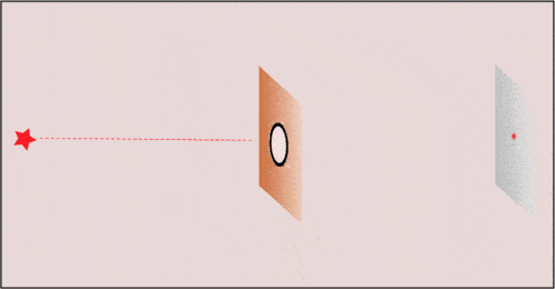

Zz, one more question: What happen if we introduce another slit, between the first one and the screen, and make sure the openings are large enough not to produce single-slit interference.
Will the "shared opening", between Slit #1 & #2, create results like if it were one tight single-slit (= interference)?

  • #46
atyy said:

atyy said:
But you do retract the claim that the particle simultaneous had a unique position and a unique momentum - as implied by the claim that it had a trajectory?
