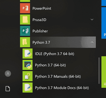

Hello,

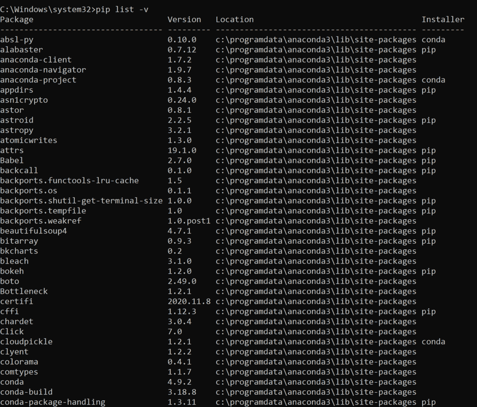

I have been trying to figure out where things are stored in Windows. For example, I have two versions of Python, one is stored in the PYthon37 folder and one in the Anaconda3 folder. See below:
I have been using pip at the command prompt to install packages/modules and when typing at the command prompt pip list -v, I see that ALL currently installed packages are stored in a subfolder of the anaconda3 folder...I didn't expect because I thought they would we be stored is a subfolder of the Python37 folder instead...
Also, when using the IDLE, which uses the Python3.7 interpreter stored in the python37 folder, I can import numpy and other modules with no problem even if they are stored in the anaconda3 folder...Why? And why did pip store the downloaded modules in a a subfolder of the anaconda3 folder?

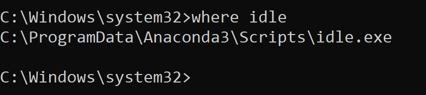

at the command prompt, I only see one pip installed in a sub-folder of the anaconda3 folder. So that explains why all the modules are saved in a subfolder of the anaconda3 folder.
However, when I am using the IDLE, which was installed with the other Python (not the Anaconda one), the modules are available from the IDLE anyway even if it uses not the Anaconda Python interpreter...
Does it mean that my Python3.7 installation did not come with pip? I thought it would...Should install another pip?
There is an IDLE also in anaconda apparently:
But when I use the IDLE I launch it from here
which is not the IDLE part of anaconda...
I would assume that's because you used the pip that came with the anaconda installation of Python to install those packages. Pip is just a Python program, so whichever Python interpreter is running it will be the one it uses to determine where packages should go.

Indeed, at the command line, when typing python, it is the Anaconda interpreter that gets launched, not the regular Python one. However, it talks about a conda environment not being activated and I am not there yet understanding what that does and means. I need to make sure I don't uninstall the correct Python :)
