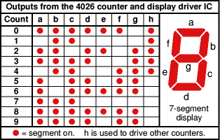

is it possible to connect 2x 7447 IC's and 2x 7 segment and input binary 0-15?
yes, that would be a fun project.
one chip takes 9 as the highest number, so you would have to do some splicing and gating.
but it's sort of redundant to use the second chip, 1 could be displayed with just one control line.
can give me a schematics on this or maybe a link so i can implement this

The 7447 is a poor choice for this.
Instead of using several chips to compensate for using the wrong decoder, you could look for a device like the Fairchild 9368 chip which decodes binary inputs of 10 to 15 as A, b, C, d, E and F which are the correct HEX outputs for these inputs.
So, you would only need one of them and one 7 segment display.

If you can't make use of any other ICs, then I don't think you can do that.
The second digit would always be a 1 or a 0, but the 7447 output on the right hand digit would be garbage for numbers greater than 9. It makes a series of letter "C"s oriented in different directions.
If you can make use of any other IC's you should throw out the 7447s and use a suitable chip. These chips are very cheap.

not at all, i was thinking of using this 4 binary input as a count-up timer given the input was from a 555 ic and a 7490.
So, just use two 7490's. They only give BCD out anyway, but you can have one driving the next. Each 7490 can drive a 7447 which can then drive a 7 segment display.
This would let you count up to 99 before it starts again.
You would then have the beginnings of a frequency counter.
You should put an AND gate on the counter with the inputs on QA and QD and the output connected to the reset of the counter
or instead you can use a 4026 ic that has the outputs decoded for a 7- segment lcd display.
if you are connecting them together then connect pin 5 of the first 4026 to pin 1 of the other
second of all, you need to give a clock pulse to pin 1 of the first countergoogle: "integrated circuits by generic number"
and click the first link. it has datasheets for every ic (except for a few)
