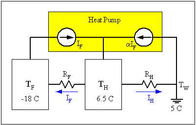

Yeah. What you have is a new equilibrium condition to solve for. The greater temperature in the house will mean that the heat pump needs to work harder. I tend to look at these problems the way I look at an electrical circuit, with a controlled current source representing the heat input that the pump generates. For the single fridge problem where the temperatures are given, something like this:
Where ##\alpha## represents the Carnot efficiency term. IF depends on the temperature difference between the house and fridge, and so does ##\alpha##.
Perhaps the diagram will give you an idea of how to treat adding another identical fridge?

I did not really get how to apply the comparison with electrical circuits. Could you give me some more advice? Or the new equation?
b) I think b should be solved by the first law of thermodynamics: W=PF->H- PH->F
I think the units on your heat flows should be just J/min.
My numbers are slightly different.
I solved the exponential decay of the outdoor fridge for both given times and found the thermal resistances 40.3 K/W and 40 K/W. I figured the second one was more accurate since it was over a longer time period, so declared the fridge's thermal resistance to be 40 K/W. That translates to a conductance of 1.50 J/(K*min). I tend to use thermal resistance rather than conductance. Just my preference.
Then for the House to Fridge heat current I used ##I_F = ΔT/R## for the given stable condition, finding that ##I_F = 0.613 W## (or 36.8 J/min). Then applying the Carnot efficiency to find the new heat introduced that turned out to be 58.8 mW or 3.53 J/min. That number corresponds to your ##P_{net}## for which you found 3.8 J/min. Not sure where the difference in values comes from!
It's the 58.8 mW that must be lost from the house to the outside. So using R = ΔT/I with a heat current of 58.8 mW and the given ΔT yields a house thermal resistance of 25.5 K/W. That's a conductance of 2.35 J/(K*min).
With the two Thermal resistances in hand the the values can be penciled into the thermal "circuit" and then nodal analysis can be used to solve for temperatures. There's only one node that has a temperature that's free to vary and that's the house temperature (it's assumed that the fridge regulates its temperature and the outside temp is stated to be constant).
Changing the circuit to take into account a second identical fridge is not difficult. Keep in mind the "trick" that nodes at the same voltage (temperature) can be joined together into a single node... no "current" will flow through a wire between nodes at the same voltage (temperature). What matters is the total resistance (conductance) between the nodes...
Write the node equation for the "house node" using the usual methods. Here temperature corresponds to voltage and heat flow in watts corresponds to current.
Keep in mind that the two current sources are controlled sources. The value of ##\alpha## is given by the temperature ratio term in your Carnot efficiency expression, and the ##I_F## value is taken from the branch current: ##I_F = \frac{T_H - T_F}{R_F}## using the variables on the diagram.

I see what you're concerned about. But this isn't a linear situation. The Carnot efficiency changes as the temperature difference changes. The pump has to work harder as the temperature difference increases, compounding the problem.
If you write out the node equation you'll find a term where the Carnot efficiency term (which depends upon the temperature difference between the house and fridge) multiplies the temperature difference between the house and fridge. That makes the problem a quadratic.
Yeah but the Carnot efficiency is in my equation (TH-TF)/TF which depends upon the difference the temperature difference. So I solved the equation for different conductances in the form of n*a, but T seems increase without end... I thought the node equation in post 14 is right...
It looks like the model goes critical after n=4; the heat pump cannot maintain the fridge temperature as the room temperature is too high and getting higher from the efforts of the pump. A runaway situation.

I solved the quadratic for the house temperature and found when the discriminant passed through zero (a negative discriminant implies an imaginary solution, i.e., no real world solution).
I also plotted the house temperature versus n (number of fridges) and noted the graph rises to a critical peak before "vanishing" into the imaginary realm.
I also ran the LTspice simulation for 5 fridges and the simulation engine balked, unable to solve the circuit. 4 fridges was fine.
For part (c) I'm not sure. It could be that they're looking for the critical point where the temperature goes unstable and the fridge can no longer operate (or at least can't maintain its setpoint temperature).
