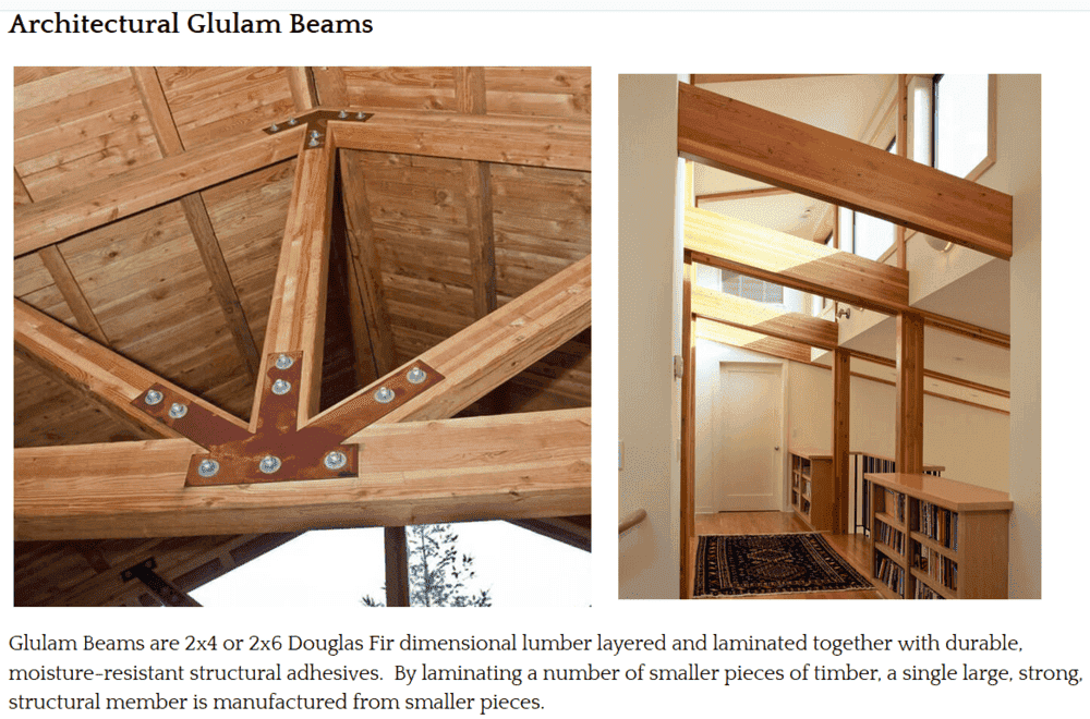

All good points and all true. I think the barrier to crack propagation is the biggest factor. Four 1" thick planks glued together make a stronger glulam than two 2" thick planks and that in turn is stronger than a single 4" thick plank.
Another factor is that the glue is always stronger than the wood so even though it is a thin layer it has a big effect, adding to the deterrence of crack propagation.
Large glulams are used for bridges, for example, in ways that equally thick beams from a single tree bole would NEVER be used. Glulams are also used for structural beams in other ways. The statement that glulams are Doug fir (in the image below) is not correct. They MAY be Doug fir or they may be Southern yellow pine, or even a few other woods.
Likes 256bits and person123

Not quite. The screws are not as effective as the glue for strength but the fact that particular grain flaws are only in half of a piece does make a two 1-unit planks screwed together stronger than a piece of single 2-unit wood.
Still, glue IS what is normally used, thus the term glulam (for glued up lamination)
