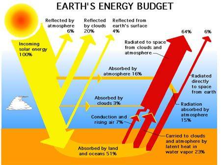

3) I found this picture on:
http://en.wikipedia.org/wiki/Earth's_energy_budget
4) It seems to show that all heat is from the sun, 19% directly absorbed, and 45% is absorbed by the atmosphere indirectly from the Earth after being heated by the sun.
How does this relate to your numbers?

1) Virtually all of the Earth's heat comes ultimately from the Sun. However, the proximate source of most of the atmosphere's heat is the Earth's surface.
2) Adiabatic temperature changes are not a factor in the Earth's climate. And, we are talking climate here, not weather.
3) Yes, this is based on the seminal article by Kiehl and Trenbarth (1997) "Earth's Annual Global Mean Energy Budget". It has been modified a bit since publication, but is still the starting point for any modern understanding of the atmosphere's heat budget. We differ somewhat on handling the enthalpy of condensation, but agree on the important points. If you want to use their percentages instead of mine, The argument remains valid.
4) Keep in mind the difference between ultimate and proximate.
5) I'm referring to "ELR" the environmental lapse rate. The other two are adiabatic and irrelevant to the question of why climatic temperatures decrease with increased elevations.
