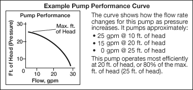

Sorry if I missed something, but I got a little lost here. For the pump you gave you linked, the flow would be between 10-13 gpm. In that case, wouldn't my pressure loss be around 2.3-3.3 psi? Thanks, again.
What measures are you taking to stop a continual flow of water to the sprinklers, even when the pump is not powered. The storage tank is 15 ft. higher than outlet!
For your questions 1 through 3, the answer is the same: the restriction of your system will dictate the pressure you will have. The thing that makes everything complicated to analyze, is that the restriction of your system depends on the flow inside the pipes (see your link about pressure loss inside pipe).
You can set the restriction of your system by designing it properly (pipe length and diameter) or you can adjust it with a pressure regulator or a valve.
The pressure regulator sets the restriction to have the desired output pressure and whatever excess flow comes from the pump, it is sent back to the tank.
The valve sets the restriction size. The pressure you will get will depend on the pressure/flow characteristic of your pump. If the valve is wide open, the flow will be high, but the pressure will be close to zero. If the valve is close, there is no flow, but the pressure is at its maximum behind in the pipe behind the valve.
Two things to remember:
  1. A pressure regulator or a valve can only add restriction to your system, i.e. if you have long pipes and/or small diameter after the valve/regulator that already creates, say, 3 psi of restriction, the valve/regulator can only increase that value.
  2. The maximum pressure or flow of the system is defined by the pump. If the pump cannot exceed, say, 10 psi, a valve/regulator will not create a larger pressure than that. The flow will depend on the design of the pump and will vary according to its pressure (high pressure -> low flow; low pressure -> high flow).
Since your sprinklers require a certain pressure to function properly, you need a pump that can produce that pressure. Remember that the sprinklers are a restriction (like a valve) and that at their working pressure, a certain flow is associated with it. In your case it is 0-35 gph @ 15-30 psi which, IMO (but I maybe wrong), means you need at least 15 psi to get 0 gph and you'll get 35 gph at 30 psi. Higher than 30 psi, the sprinkler will probably break. With the low flow you need, you probably want to hang on the 15 psi side.
Since you want a certain flow, you need a pump that can deliver this flow AT the desired pressure. Ideally it would deliver exactly the flow you want at the pressure you want.
If you would use a pump that has a larger flow than you need at the pressure required, the higher flow would increase the restriction in the system, thus the pressure as well, and you would get whatever flow the pump would give at that new pressure. In that case, you can use a pressure regulator that will only allow a certain pressure in your system and any excess flow that would tend to increase the pressure, will be diverted back to the tank.
Pumpquestions said:
4) Am I correct that something like this pump provide sufficient pressure, while having a lower gpm?
This is a transfer pump that is used to drain something. In this case, the pump doesn't feed any system, the water is just thrown out in the open air, so essentially no restriction. The only spec needed is then the maximum flow, which is given. In the case you would drain water from a basement that was flooded, you would need to pump the water out at ground level. This is why they also give the flow at 10 ft of head. Unfortunately, they don't give the maximum pressure the pump can give, i.e. when flow is zero (and there is one) because buyers of this kind of pump usually don't care. Unless the spec is provided, your guess would be as good as mine.
The specs for the pump in my link defines 13.5 gpm @ 1 ft and 10.2 gpm @ 10 ft, but also 0 gpm @ 24.5 ft; That is what «maximum feet of head» means. It's you that decide how much flow that you want. You want 0.133 gpm, you will get 0.133 gpm everywhere in your system. What you are now trying to do is to design your system to achieve that goal.
Look at the following graph to visualize how pressure relates to flow with a pump (any pump):
%2Fimages1.mcmaster.com%2FmvA%2Fcontents%2Fgfx%2Fsmall%2Fc01a-example-pump-performance-curve-d1s.png
