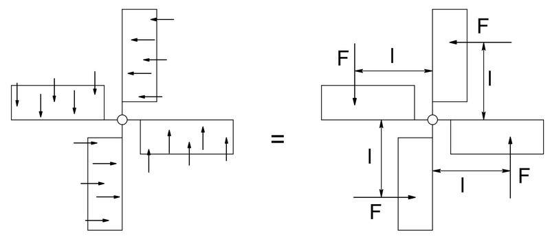

To make the windmill's wheel spin you need forces acting on the blades in the rotation plane. These forces are acting over the entire surface of the blades, but you could sum them up and imagine one force acting in one point of each blade. These forces multiplied with the distance from the shaft yields the torque ##T##.
$$T=F\cdot l$$
Now, if you start rotating the rotor of the generator, due to electrical induction current is produced, which generates a magnetic field. This magnetic field tries to stop the rotor's motion - if the rotor stops, no current will be produced anymore. If the torque generated by the wind is as strong as the decelerating torque of the magnetic field, the windmill spins with constant speed producing constant current. If you want to produce more current, the magnetic field increases and you also need more wind (a higher torque) to keep the windmill spinning.
